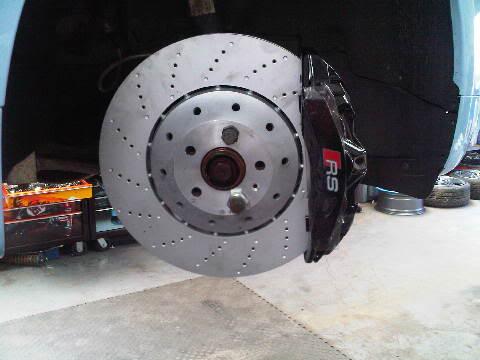

Well after suffering quite a few months of juddering every time I pressed the brake I decided to bin the Alcons and fit these mothers
Needed a little work to fit but nothing Darren and the boys and G-Werkes couldn't handle so here they
RS6 V10 390mm six pots
And yes those are 19's, they work suberb, no more juddering

May i ask what work was needed to make them fit the mk V platform?? Spacers? Specific wheel ET?  :popcornsoda:

Work Required
A small amount of machining of the caliper to get it to fit 5mm no structural integrity affected
A 2mm spacer behind disc to center it on the pads
So not a lot of work they are Sportec rims not sure on the off set but you will need 19"s minimum
The whole kit is 2k and as for the consumables cheaper than Alcon

if you go for the RS6 b7 discs with RS4 calipers you dont need to do any machining and they JUST fit under team dynamic 1.2s (18")
as per this setup... costly but :drool: :drool: :drool: :drool: :drool:

Why go that small they are almost the same size as V6 brakes  :grin:
Now these fit straight on and exactly how I wanted them BIG and Powerful
