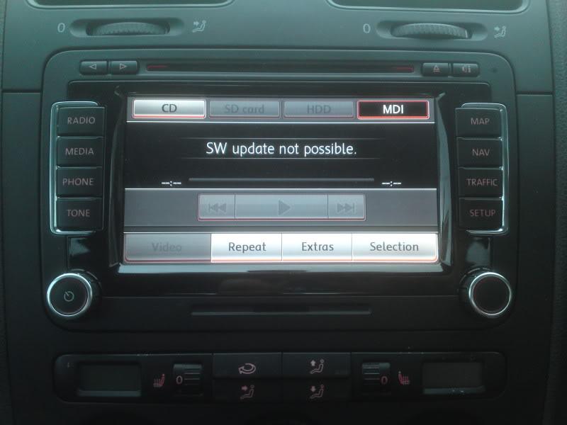

Thanks for the link Camel.
DL'ed the file, copied it to a blank memory stick (as 'mdi.bin.enc') and inserted it when the RNS was off. Turned it on, pointed to media and:
 :indifferent:
This clearly seems bit of a challenge  :wink:
Pete

« Reply #7 on: June 09, 2010, 03:10:58 pm »
Wonder if you current MDI is below firmware 900, which this new software won't upgrade from.
I think there is another link for the previous update, I'll have a look  .......
Older update is here http://www.my-gti.com/wp-content/uploads/mdi.bin.kw33-2009.enc

Whatever I did in the process, it seems to have fixed it Camel. So thanks matey  :happy2:
I ran both the latest MDI update and the version previous, both produced the error 2 posts up but inadvertently, it's fixed it as I can't reproduce it now. Every time it seems to load the MDI in about a second and resumes playing from last point  :congrats:
