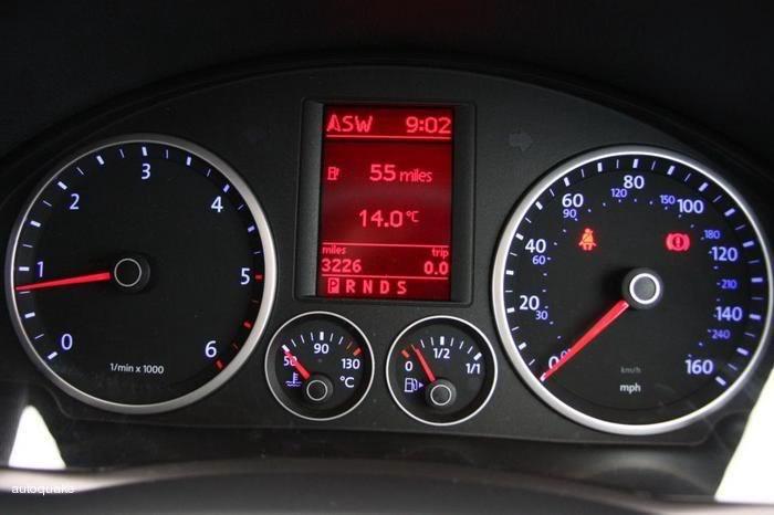

In the two pictures below, in the top left corner of the display one shows a compass and the other doesn't.
Mine is the one that doesn't! And I don't know why

Lower pic is GTI clocks, top looks like bogo golf ones if this helps ?.

Good spot again Gene, but I just robbed a photo off t'internet so that I could show what I meant.
