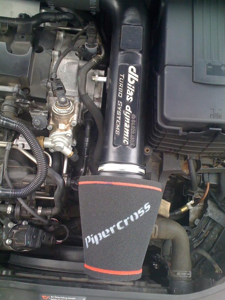

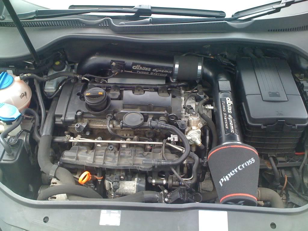

For those that wanted pics:
Why? well I found that most intakes on the Mk5 are stupidly noisy which is mainly due to manufacturers using very thin walled tubing that creates a very 'whooshy' noise at low throttle and low rpm. The Dbilas uses a much thicker wall cast material and doesnt have the whooshy noises, but the Dbilas airbox IS restrictive due to its rubbish design, logs show a difference of 200mb extra boost pressure and around 18g/s more on the AFM logs at some rpm points. Intake temps under load are no different despite the open filter and the car feels so much better under light and heavy load, more eager and hits peak boost a LOT earlier. It also sounds great. Nice and quiet when you want it to be as well.
I can get these filters in for around £40, if you have a Dbilas, give it a go. I will gladly refund you if you are not happy with the transformation. (above gains / results are based on a stage 2+ K04)

The pipercross venom looks OK actually, I am yet to test one and see if they sound like a hoover (like most inlets do)
Pipercross claim that the venom unit will flow 350+bhp without restriction so it may be a good option, saying that I tried a universal venom filter unit and it had no reinforcement inside the filter and it sucked the filter inside out on a 330bhp car!

do you suffer heat soak issus when in traffic with that filter sucking in the hot engine air?
I rarely get out of the car and open the bonnet in traffic, but I Imagine the filter is hot, but I have logged intake temps (at the manifold) after the car has sat running for a good 5 mins while setting up the logging and the intake temps recover very quickly, this is helped by the ultra efficient Twintercooler that I have fitted, which I rate as one of my favourite mods on my car.

Your Dbilas looks high on the turbo side? Like its sloping down?
Think thats down to the braket on the right hand side not being tight, need to make something a little more substantial that the poor effort that Dbilas designed  :confused:
Yep i keep stripping the thread!
Whats clearance like between the bonnet and cone filter?
