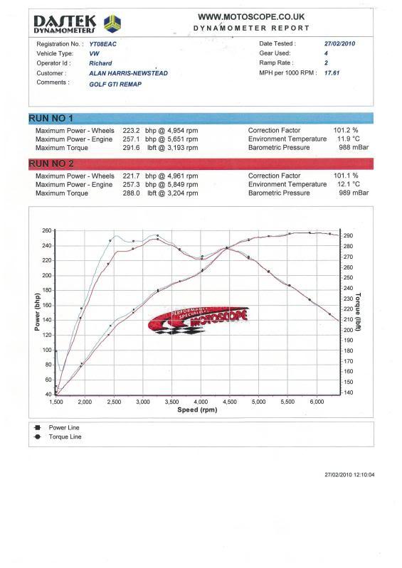

they quote 240 Hp which is exactly what my car made at the last rolling road day.  she made 24)hp @ 5000rpm then flattened out until 6250rpm.  torque was 270Ibft between 3-3.5k rpm.  tailed off abit though, hopefully the intake will cure that a bit more with some more air flow

she has the same map as me, so do you really think there is a 17H difference, i very much doubt it, its a different rolling road, and as a result will never give the same output, although upto about 5k mine and hers are pretty much identical before i get heatsoak and power dies off.
most of the guys with the shark performance map have all had the same results as mine pretty much, so what your seeing is either a very good car, or dyno lottery.
Dont get hung up on figures, realistically stage 1 will give 235-245Hp.  they can quite easily make more power, but then you wil be pushing high EGTs, and timing etc,  cars making higher outputs, miht not necessarily be faster on the road either as thy can be peaky in their output.

Heres my Graph... I agree your point on the figures..So reckon its 240 to 245 which is standard for a stage 1 so I,m happy with my map.
Unless you guys see any problem here.....  :popcornsoda:

Just out of curiosity, I am guessing that graph was done on the same day as the infamous Seat Cupra dyno day?
Offline gulfstream11
  • Posts: 586
Re: M-Flash superchip
« Reply #29 on: June 29, 2010, 12:53:39 pm »
Correctomundo dude.. :signLOL:
I,m guessing it was a fubar day..If its any help I went on before Jay in his S3.
