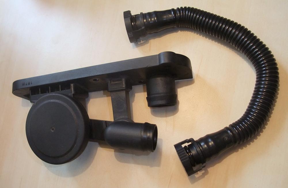

THE OEM PCV:
The 2.0T FSI engine comes with a closed PCV valve which obviously functions but as with most oem factory components it is designed and manufactured to restrictive rules and criteria and which can be improved by replacing with aftermarket components.
As do ALL engines from ALL manufacturers.  And on standard engines, the OEM system is perfectly fine (providing you use decent fuel and high quality oils).

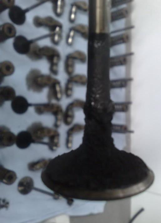

^ Intake valve from stripped 2.0T FSI engine with oem PCV after xx,000 miles.
That pic needs considerably more explanation.  What fuel was used?  What oil was used?  Was the engine modified?  How does that compare to an old skool manifold injected valve?  You will be well shocked by the answer to the latter!

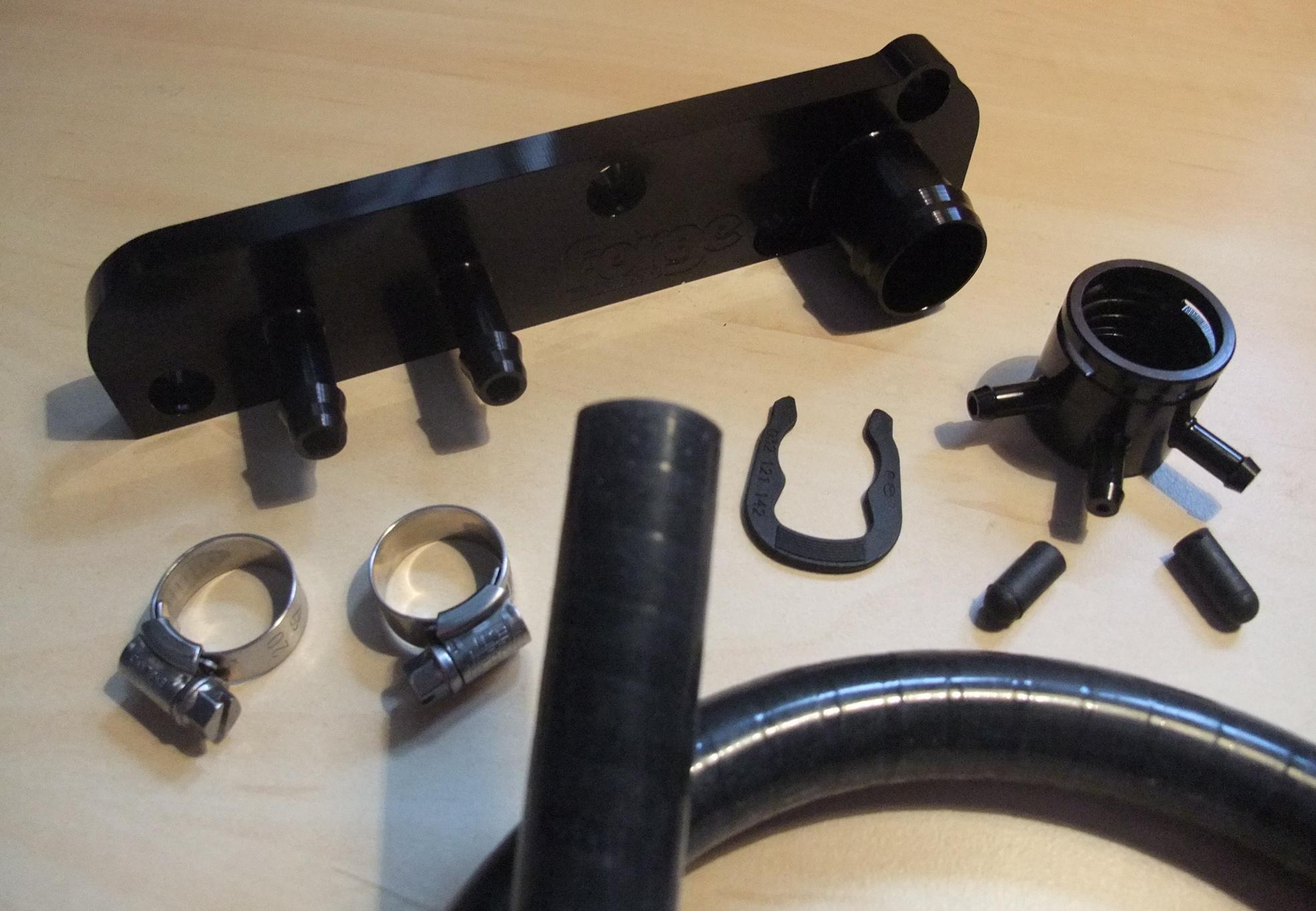

Why is there only 2 rubber blanks provided when there are 3 nipples?
