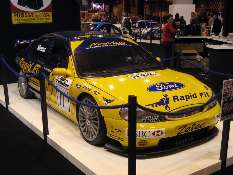

I was very surprised to realise how much smaller the wheels were on the racing SEAT's recently : -
Not directly on topic but related.

Yeah its the S2000 regs, need to be running 17" wheels..
Not like the old super tourers with 19" wheels and 450mm discs!
