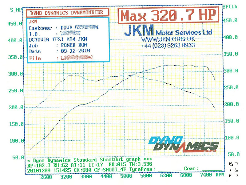

« Reply #64 on: December 11, 2010, 12:50:05 pm »
Just got K04'd   :happy2:
Car:  Skoda Octavia vRS 2.0 TFSI
tuner/stage/settings Revo stage 3   Settings:b-7 t-6 f-7
Modifications  K04 turbo conversion, ITG intake, Pipewerx DP, Piper cat-back, Twintercooler, S3 injectors, autotech HPFP
Type of Dyno/operator  Dyno dynamics/Jkm perfomance
miscellaneous details

« Reply #65 on: December 11, 2010, 12:57:06 pm »
very nice mate.
is your redline (hard limiter) at 7500 rpm??
i didn't think the 2.0 TFSI was allowed to rev that far really.,

« Reply #66 on: December 11, 2010, 02:02:25 pm »
Yes, I believe so

« Reply #68 on: December 11, 2010, 04:09:00 pm »
interesting u both seem to have a flat spot in the middle of the rev range!!
