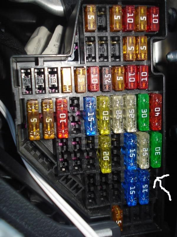

« Reply #13 on: July 27, 2010, 01:50:56 pm »
that lead that i gave u the link for will come with a long red wire that u need to run for the ignition feed.
crimp a spade connector on to it and slot it into the empty slot shown below and hey presto, one ignition feed for ur parrot to come on and off with ur ignition.
