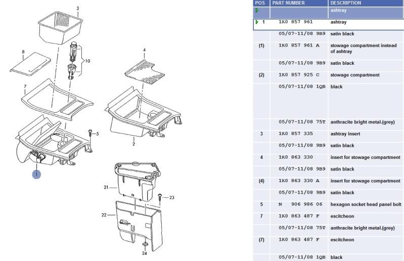

While we are there and as Chungster 'forgot' he had sold his.
Does anyone have a part number for one of these.
Its the storage bin instead of the ashtray. :smiley:
Did VW do a cost cutting excercise on this part as well. Mine has a cubby hole exactly the same as the above picture fitted, but with the hinged lid fitted (just like an ashtray). Has the same rubber mat fitted and a Power socket with a spring flap on it ?

Insert for stowage compartment
satin black 1K0 863 330A
Seems this is the insert for the Ashtray not the Stowage compartment.
Anyone?

The open storage compartment is 1K0 857 925 C 1QB £21
There are two mats (4) 1K0 863 330 9B9 and 1K0 863 330 A 9B9
Not sure what the difference is as they both say smoking/non smoking  :confused:
The ashtray (with lid) consists of the following
Main part 1K0 857 961 9B9 £33
Top section  1K0 863 487 F 1QB £16
Lid 1K0 857 351 F 1QB £12
^^^^^ is not a Golf V part, its from the EOS or Golf VI (as it has more switch positions) but will fit on the Golf V

The one I have fitted has just the 4 buttons and was PN 1K0  857 925C Black 1QB.
The bag for the insert reads 1K0 863 330 A 9B9 but the contents are the same as my old covered bin as they have a rectangular key on the back. Its PN is 1K0 863 330 A with 9B9 being the trim colour I guess.  :confused:
I will speak with the parts man at VW later.  :sad1:

The difference in the insert mats is Armrest fitted or not.  Don't know why??
Looks like you are correct
1K0 863 330 A
Front Center Armrest
Smoking/Non Smoking
1K0 863 330
Without Center armrest front
Smoking/Non Smoking
and 9B9 is the colour (black)
Cant see why the armrest matters as its nowhere near it  :confused:
