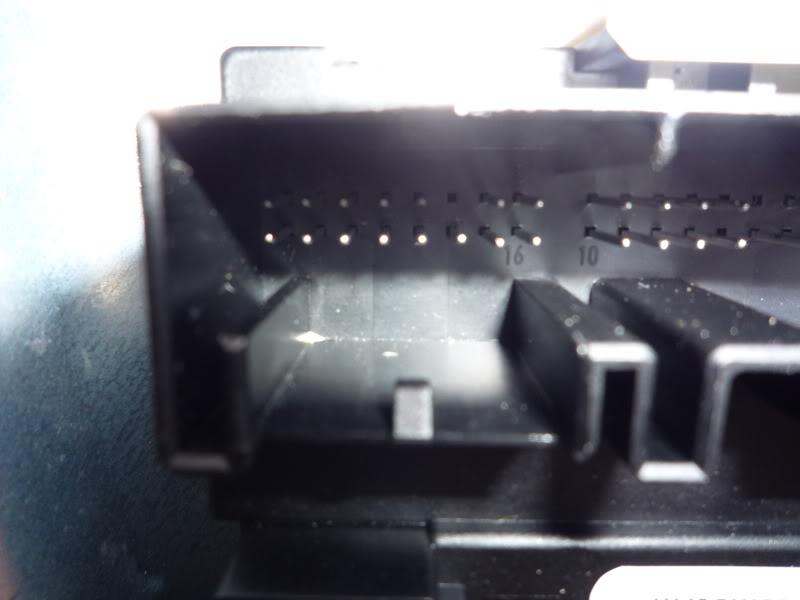

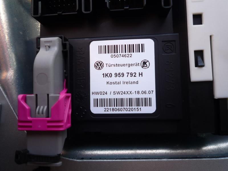

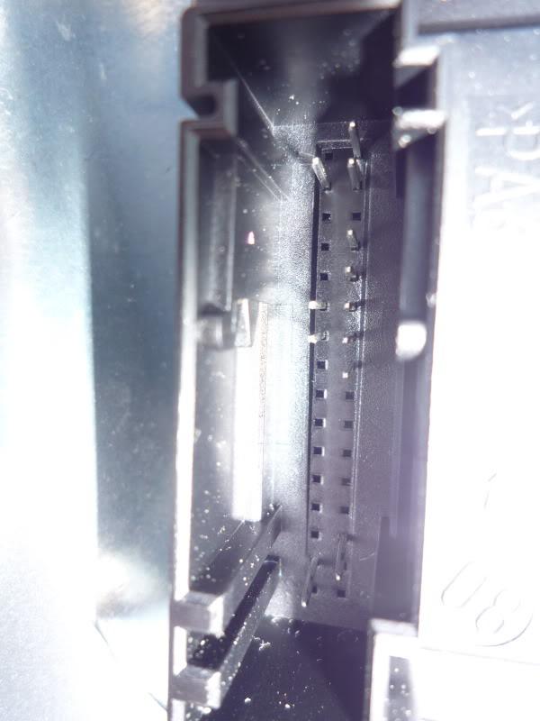

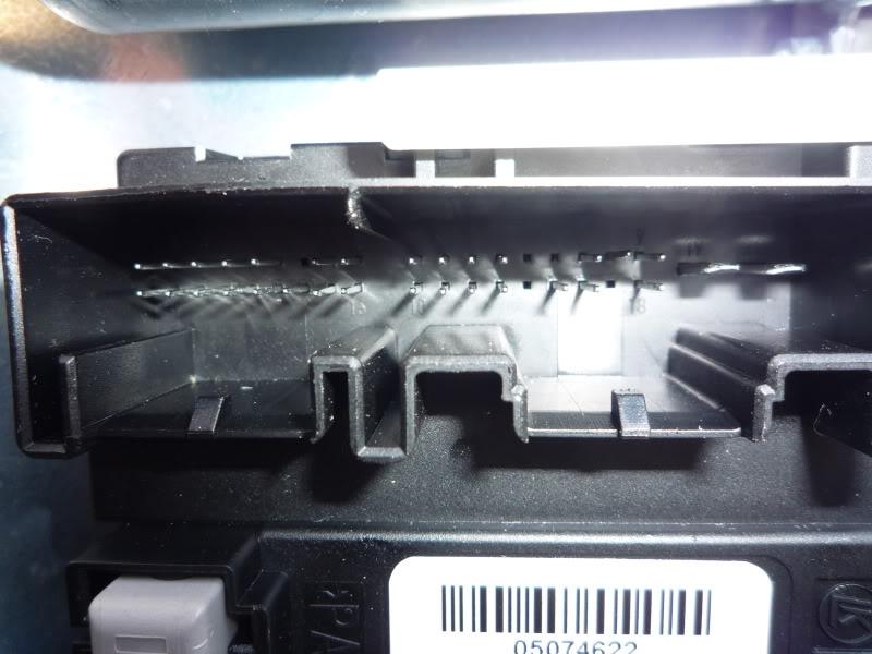

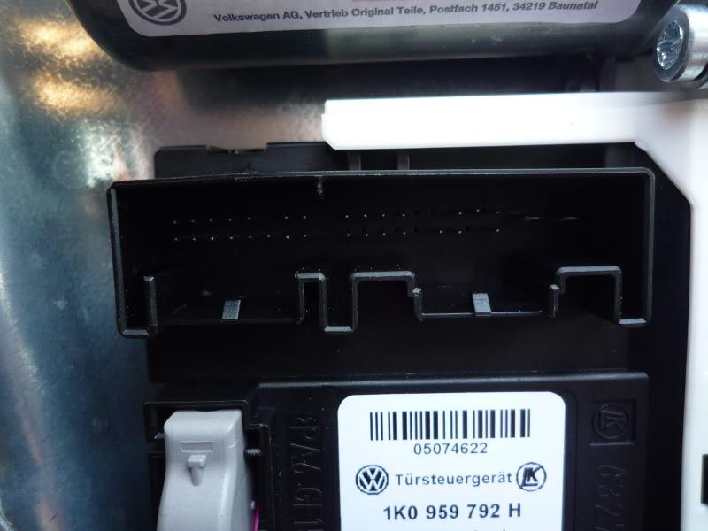

Right i still cant get this to work properly!!!
took my door cover off and had a look at the door controller
this is the wiring i have in the wing mirror loom.
Pin 1= Grey/Yellow Stripe
Pin 2= Grey/White Stripe
Pin 3= White/Yellow Stripe
Pin 4= Red
Pin 5= Brown/White Stripe
Pin 6= Empty
Pin 7= Black/Red Stripe
Pin 8= Black/Grey Stripe
Pin 9= Yellow
Pin 10= Green
Pin 11= Black/Blue Stripe
Pin 12= White
Pin 13= Blue/Red Stripe
Pin 14= Purple
Pin 15= Blue
Pin 16= Black/Green Stripe
scott :happy2:

Its like the When you then take the car out of reverse and switch off the ignition the mirror should return to the normal position but its like its arse for elbow so maybe 2 wires are in the wrong way round?
