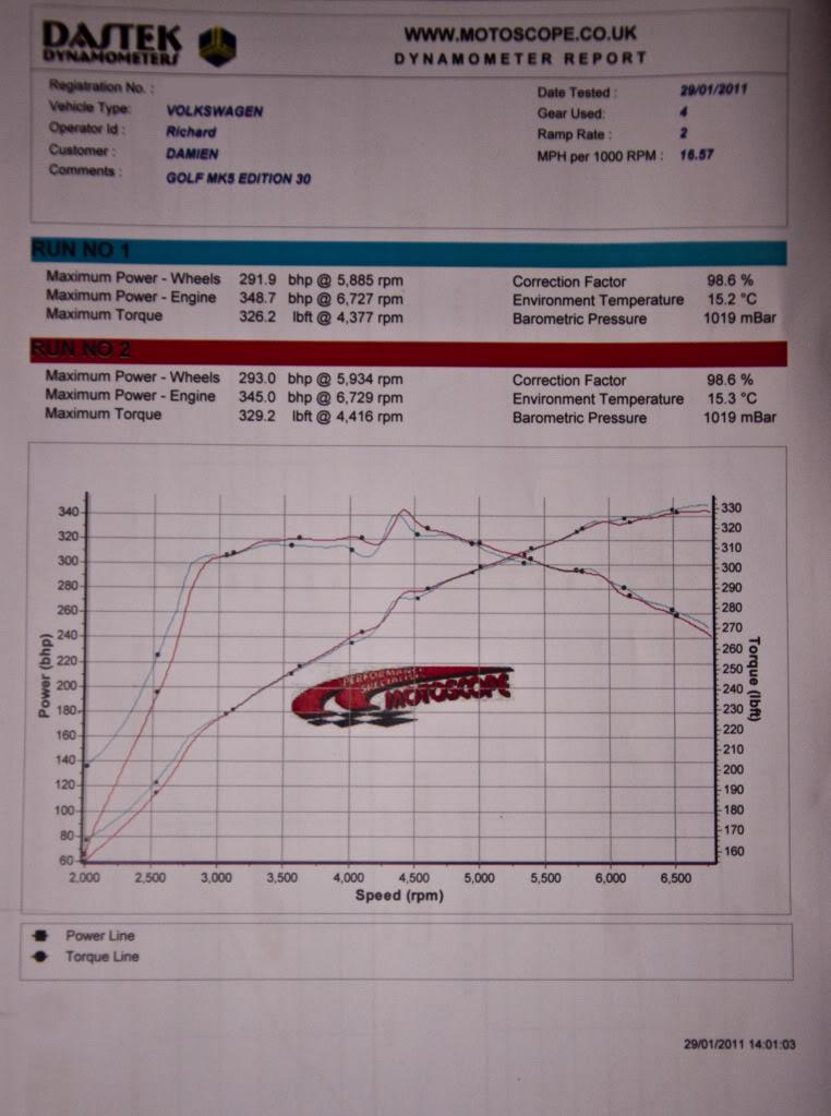

Do you know what was the at the wheels reading?
Have you had it on the PDT dyno yet?
No, is not been on PDT's rollers, Geof.
Power at the wheels was 293bhp. Which isn't too far out....
A lot of the higher powered cars had problems with traction on the rollers due to VERY cold tyres and also poor tyres..
Even mine was spinning up in 4th  :confused:

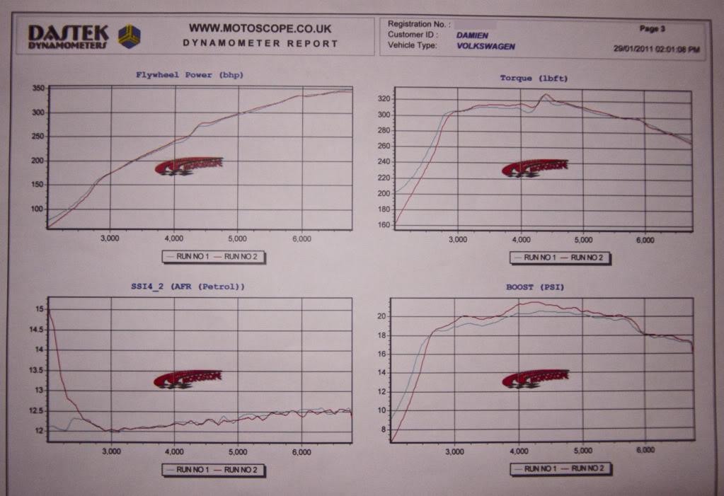

Graphs..

Just for my clarification... is the quoted 230PS for the edition at the wheels?

No, thats at the flywheel, Rich..

Was it a warm day down in North yorkshire yesterday? Graph shows 15.3 degrees?
It was freezing outside but it was actualy warm inside the dyne, Dave. The temp probe for the dyne was quite close to the cars..
Is yours stage one?
Stage 1 mate..
I know my results are not right, realisticly +30-40bhp out... Just posted the graphs for a laugh realy (although they are nice enough graphs if you dont look at the numbes (or the clutch slip..))..

Ahh i see now!  :signLOL:
The power deliver does look very linear!  :happy2:

Yep, its a VERY smooth map and just look at how well it holds torque  :smiley:

Nice high resuts :laugh:

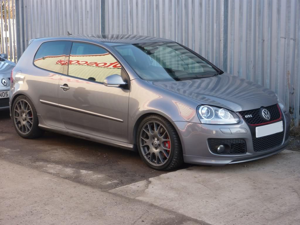

Was yours the car at the front of the shop? I like the colour of the pescaras, same shade I'm hoping to get mine done this year :happy2:

Yes mate, I was parked outside the front of the shop after it was on the rollers  :happy2:
Here's a pic that someone else took when it was in the que to go on the rollers..

Being Dastek rollers then the figures must be 100% correct! lol!
Going back to page 5, the car looks damn tasty after the wash.  :drinking:
