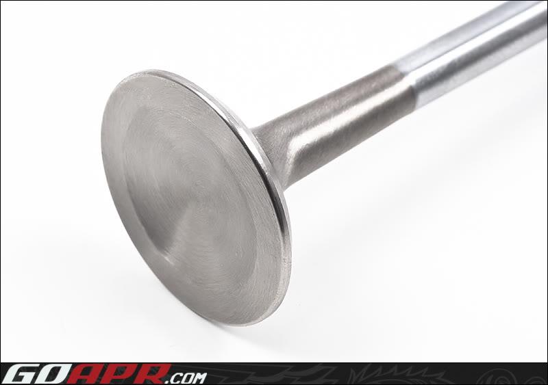

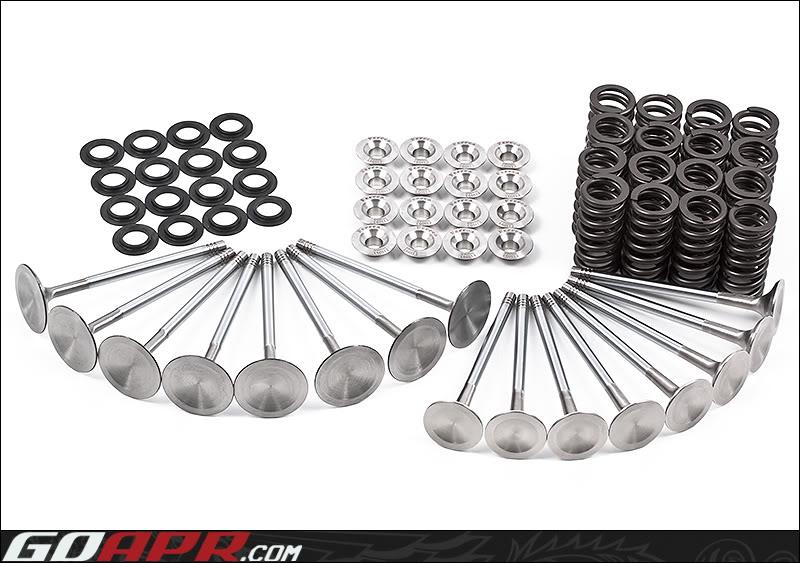

•   Ferrera Valve Train -
This is new and has not been done to in previous builds and is being done according to my request , just for the extra strength .
this is a complete kit and should hold much higher revs than the stock valves. Although our engines are limited by other factors such as the HPFP.

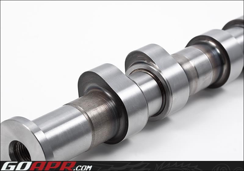

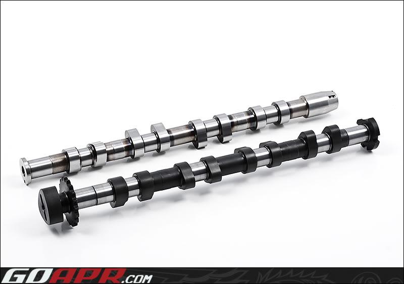

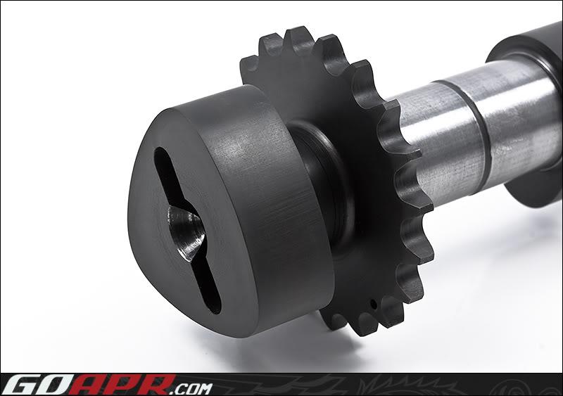

•   Schrick Camshafts -
Those camshafts were discussed a lot in the forums but rarely used since there is no software on the market apart from APR stage 4 that makes use of the higher lift and duration.
those are a pain to get hold of since they were of limited production and didn't sell well and so not massively produced.

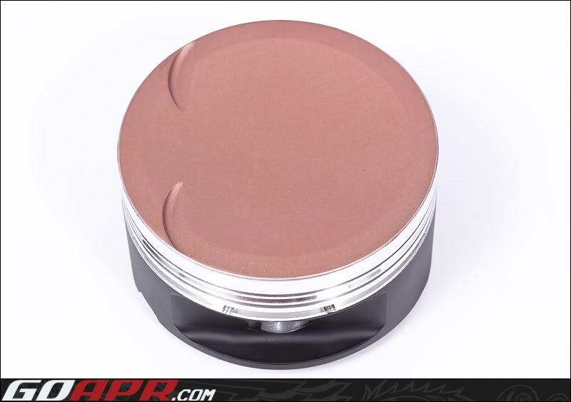

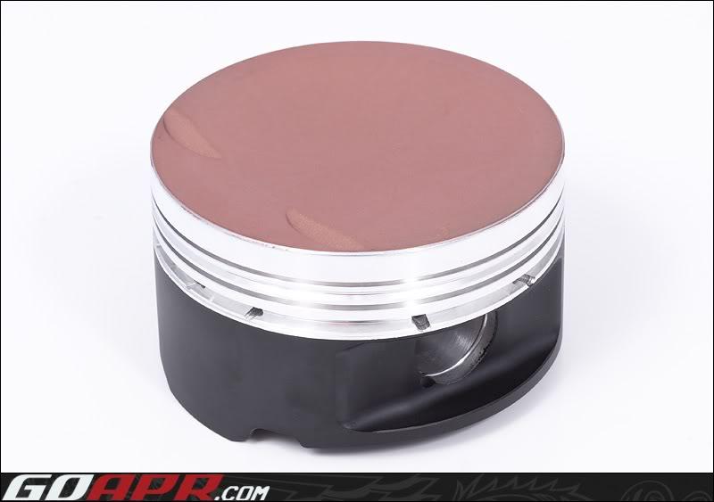

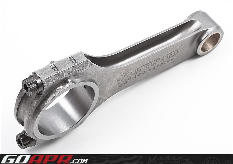

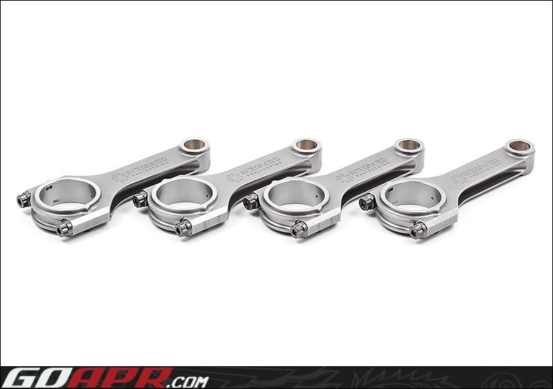

•   Rods and Pistons -
the block is being bored slightly to 83mm and a set of JE pistons with IE rods is being installed.
Compression ratio is dropped only slightly (compared to my stock 9.8:1) to 9.5:1
Those are the main things happening in the engine build. There are of-course tons of other misc items around those main parts.
