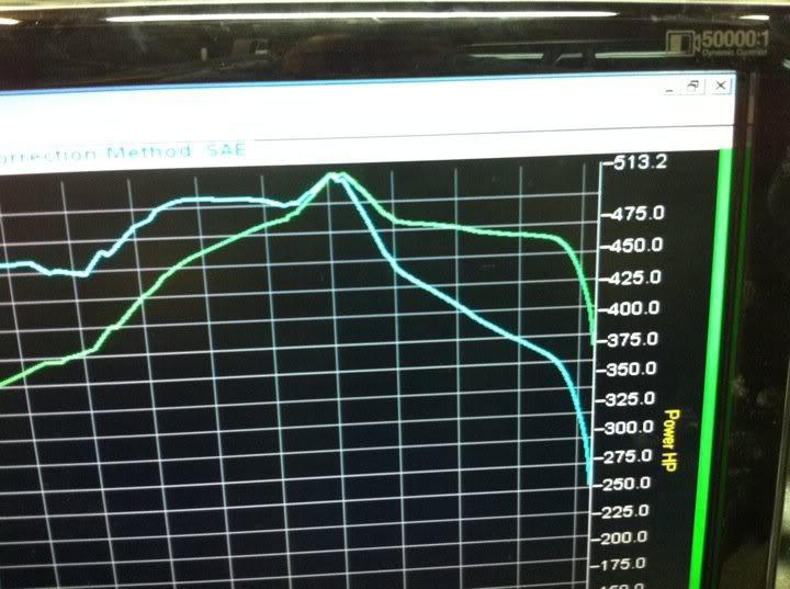

short update will load pics and stuff later next week
had a very long and busy week with apr engineers here in israel and i am dead tired
we have finished race fuel celebration
513 wheel horse power
over 65 kgm of torque
over 220 whp at 3500 rpm
revo giac dealers did not come to dyno to proof it so it was done in the presence of motec and haltech distributers
motec distributer did not believe the nnumber so he set the dyno himself and did the pull with him in the car. Pulled 512
so this must be yours then :happy2:

just wanted to sum things up a little and say some thank yous. , although later this week i will sort all pics and data and load them.
first of all about the final results.
the car is currently on with 2 different files (i driven it around 80-100 miles on both today).
the first is the race fuel file which takes the 2871R as far as it can go and left many people shocked since no one belived that this tiny turbo can make this numbers. as was shared, it makes 513WHP and it is absolutly mental to drive.
the turbo is even more avilable than on stage 3 cars and massive power starts just after 3000rpm and goes all the way to the redline.
the other file is the 98ron file which i have asked to make very tame and safe in relation. we don't use any addetives such as methanol and timing are not advanced to the max to allow for east adaption to weather and condition changes. also the turbo never goes above 80% duty cycle so a long life for the engine and turbo are expected with this file. this file puts out 402whp
overall , i just drove the car around 100 miles, and i need some time to get used to it. it is absolutly mental , you just press the pedal at 3000 rpm and the car next to you suddenly is half a mile back.

very interesting stuff this.
Looking at Garrett's site, none of the GT2871R's are rated to over 475bhp. Fact you have 513WHP (which suggests its in the realms of 560+ @ Flywheel) is quite amazing.
timing advance is the key.
at 513whp turbo is at 100% load.
we had one run of 520whp but it needed so much more advance over 513 it wasn't worth it.

since you have built the bottom end and lowered the compression i guess this extra power has come from the ignition advance, ported head and new cams then?
i just find it slightly strange that the turbo manufactures have nearly under rated their own turbo by 100Hp
the main reasons for that insane number on C16 are the camshafts , which are magic with the right tune as well as massive timing advance allowed by the C16 fuel.
as an APR engineer described it , since it was the first time they worked with it, the fuel is "magic in a can".
