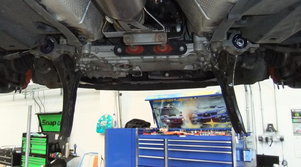

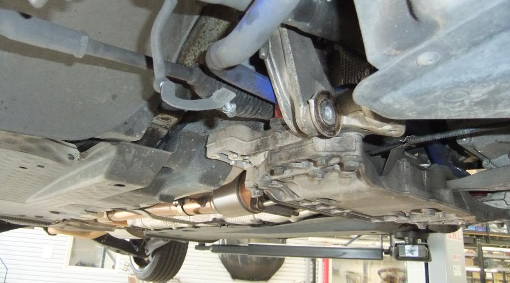

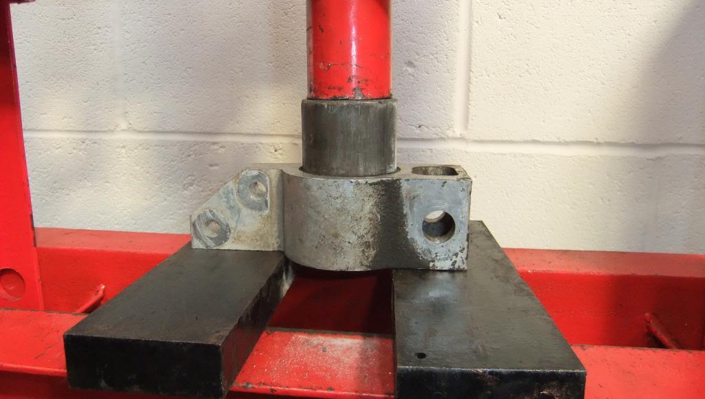

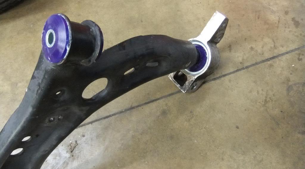

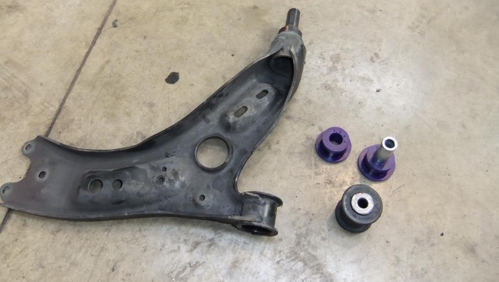

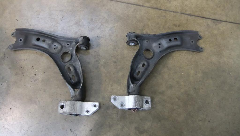

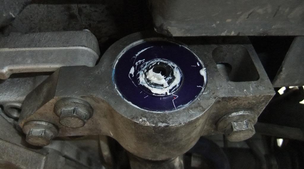

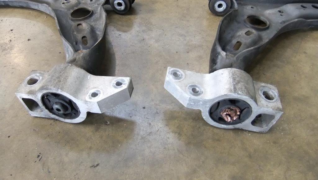

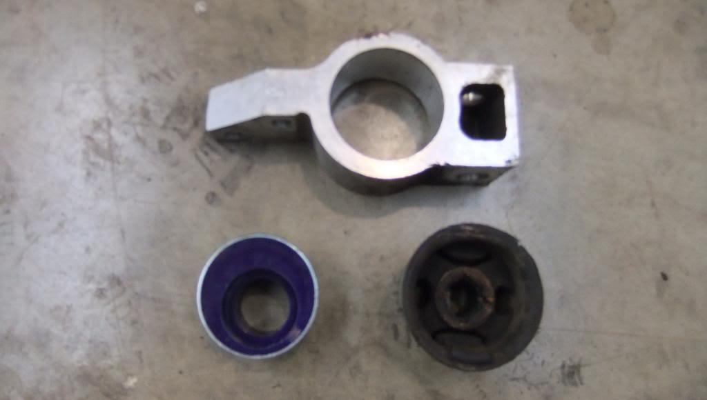

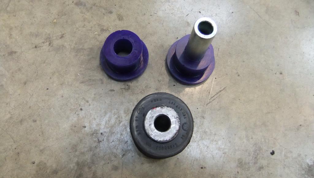

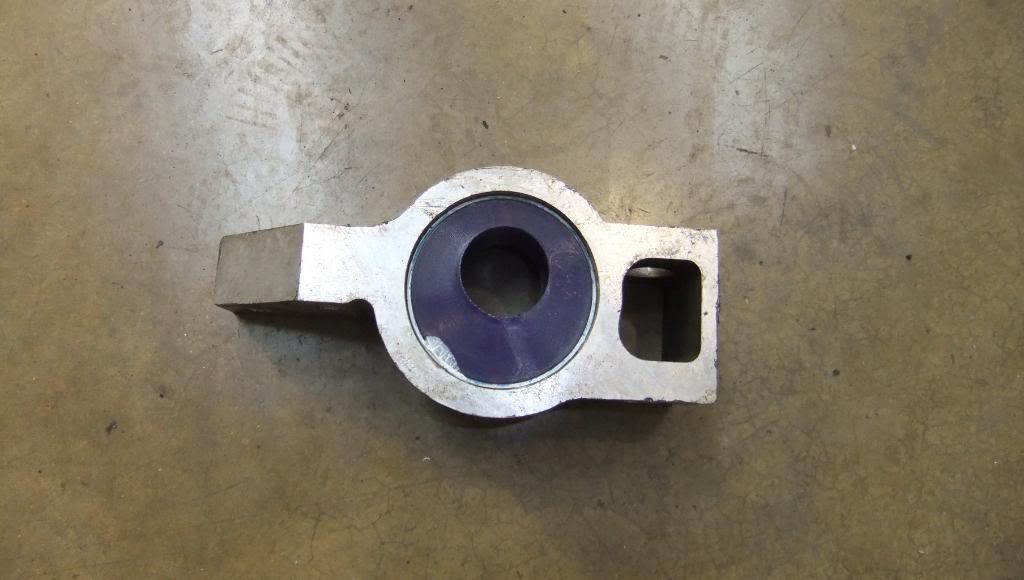

Here are some pic's the TT Shop kindly took of the install process: -

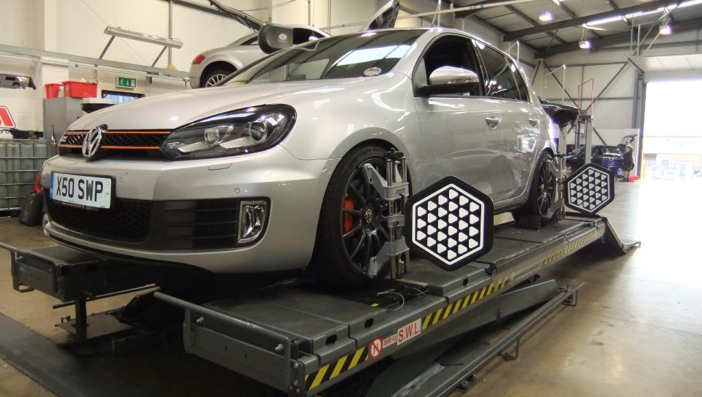

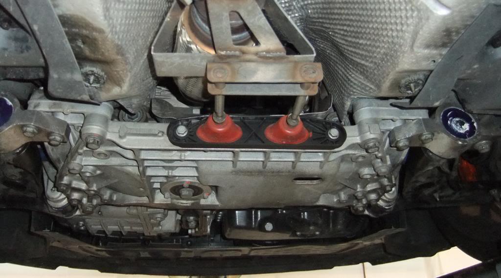

And the car on the ramp ready for alignment: -
All done: -
In total the installation took 2.5 hours  :smiley:

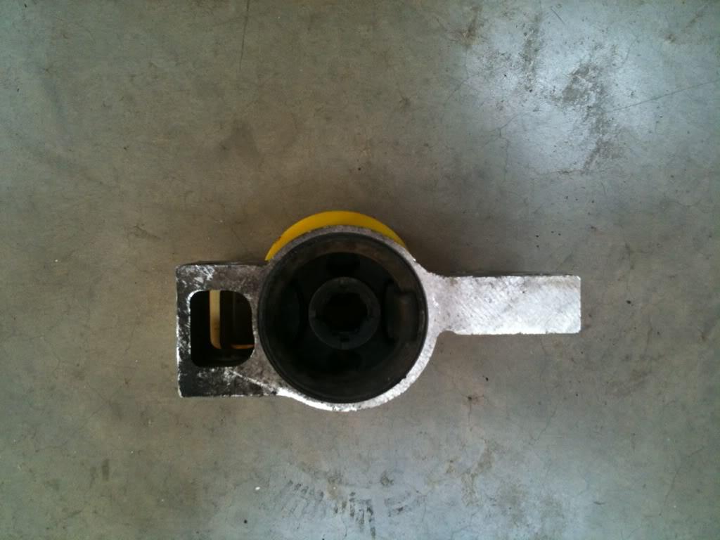

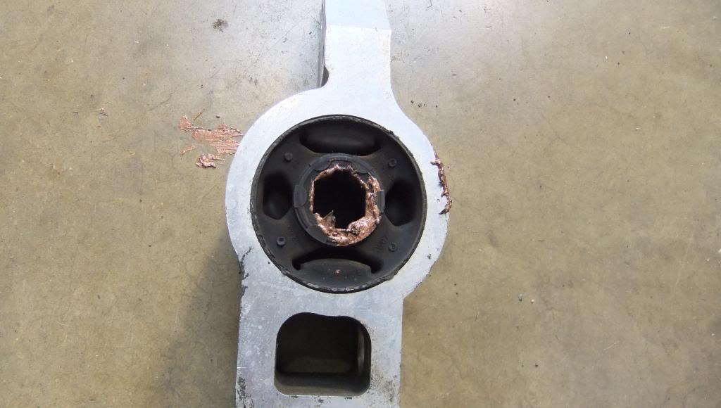

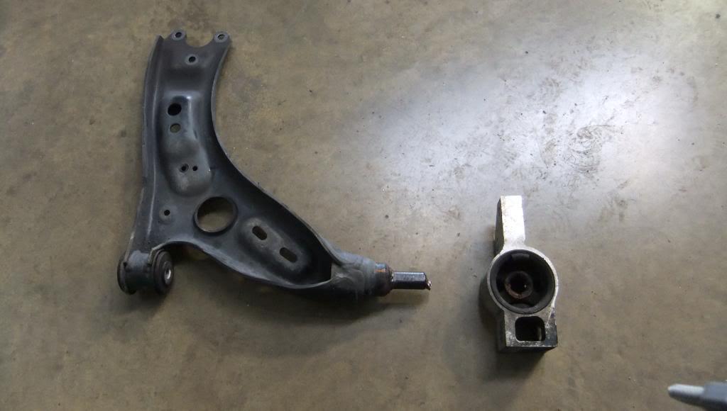

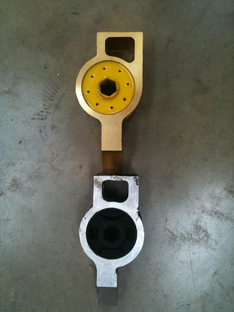

^^^ I think it would have fitted but the alignment would be out, it was only because Dave compared the original to the WALK side by side he found the issue: -
The second image show the difference in the general shape, so when the mounting holes are lined up the centre hole of the walk and the original bush is about 10mm different.

Its actually meant to be different in shape.  They have done that to get the different caster and camber settings.  The console for the TT arms is completly different, but the WALK still fits fine and give a great caster angle.  Im fitting the WALK kit on my other halfs Altea tonight so will get some pics of the two consoles next to each other.
