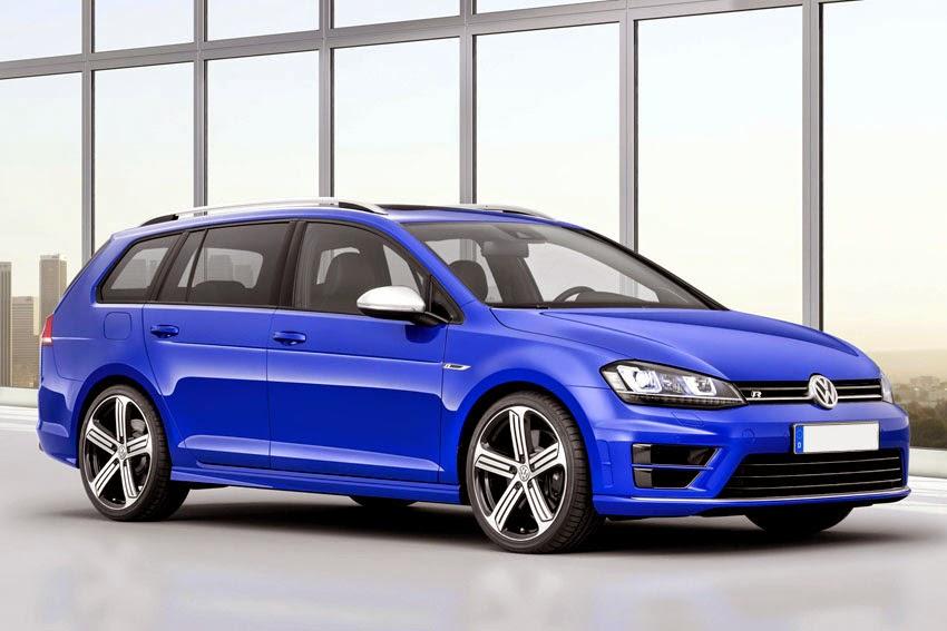

I've contemplated having the front ARB fitted as well while Alex fits the downpipe in the new year.....It's about the only mod left to do.
Then again, that pesky Golf R estate has locked it's sights on me and I just can't shake it off!!!

Not sure. Could be the fact the front is now 100% polybushed.
Golf R wagon?? Do it!!!  :drool:
