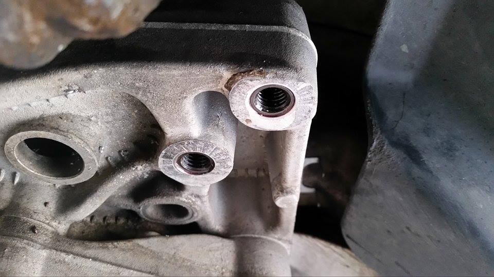

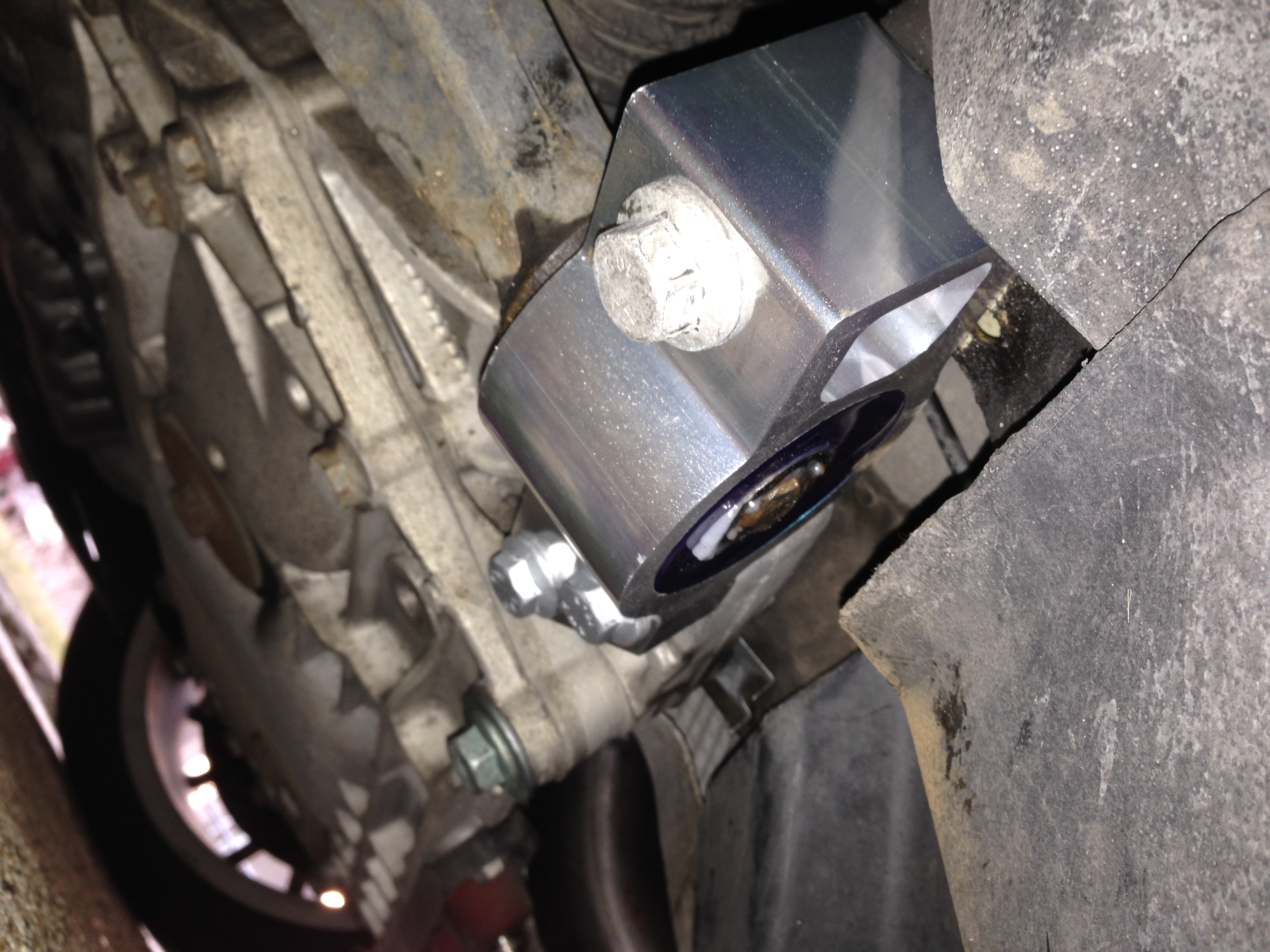

Picked up my car today. Alex had drilled/tapped and time-serted the 4 smaller console bolts... also finding out that my WALK bush had finally given way... so guess what?
... yep.. Superpro ALK.
Seems much better now, hopefully it stays that way.

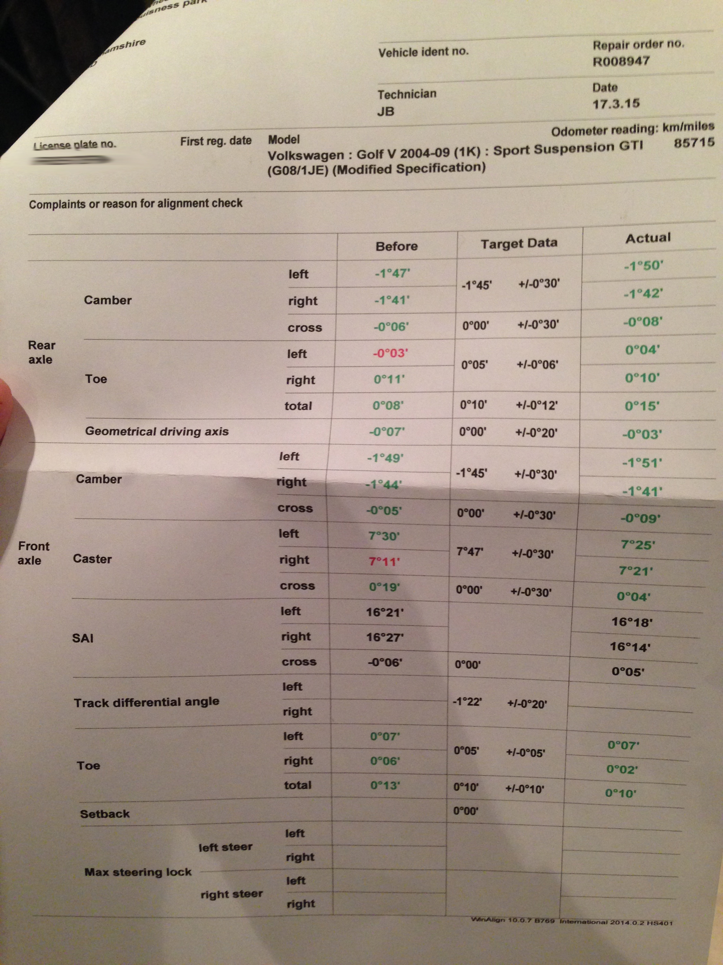

Few more pics alex just sent over.
Its going into Wheels in Motion for full hunter alignment on Tuesday too, as they owe me a free one.  :smiley:

« Reply #2121 on: March 17, 2015, 10:56:58 pm »
Not exactly bang on... but it will do until something else drops off and it needs doing again. Rear adjusters are seizing up so they need swapping out at some point... the list gets longer.
