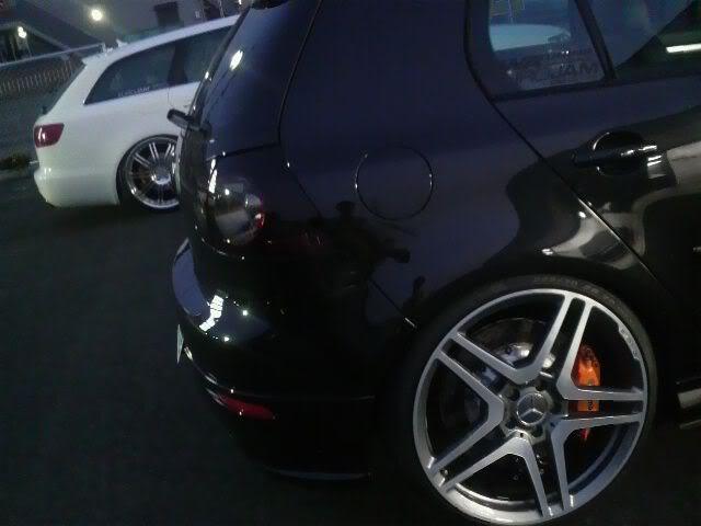

the top of the favourite list, the full monty AMG Magnesium rims

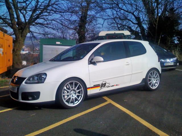

« Reply #33 on: December 09, 2010, 01:27:36 pm »
as above
this was a stop gap cheaper option but i,m still loving it so they staying for a while yet!
matsu
oh decided to keep the lms for summer get refurbed and powder coated just like this
:evilgrin: :jumpmove:

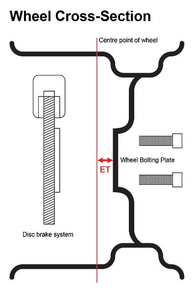

There are some fantastic wheels here but how can you tell what wheels will fit a MK5/6?
I know the studs are 5 x 112 but how wide can you go without any arch alteration or what offset can you run with?
What does offset actually mean anyway. Seen all sorts of number quoted but don't really know.
Keep the pics coming...seen about 8 i'm interested in!

Offset: if the rim is placed exactly over the middle (where the rims touches the hub) the offset is 0. the further in the rim is compared to where the rim touches the hub, the higher offset, for instance ET 51 ( standard on the golf) means the rim is 51mm futher in that the center of the rim  :happy2:
You can go to 8,5 and with ET 48 without trouble if 225 tyres are used.  :santa:

This may further help explain:

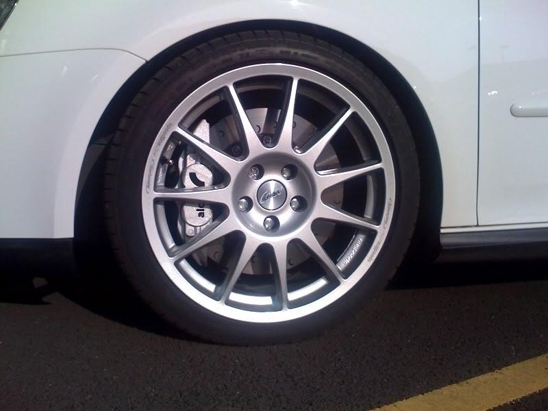

It's worth noting that if you use TUV approved PCD correction bolts and ensure the spigot is 100% right, then the whole 114.2 Jap world is your oyster. The OZs below were Jap fitment and I used them on track with no problems.
Speedline Turini. 18x8 ET42
OZ magnesium. 18x8 ET47
« Last Edit: December 20, 2010, 04:07:05 pm by tony_danza »

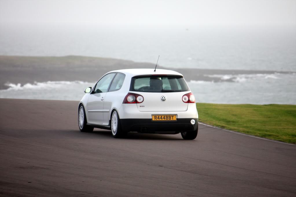

Smoke Chrome Monza 2's (Hope you don't mind RR)
....On the contrary! I'm flattered  :drinking:
I can't think what inspired you to start this thread, Nath  :wink:
Oh dear! Have I given you another 'trouser moment'?   :evilgrin:
#Are they 19s? They look fantastic!!!
w12's from Illetronik's tread, More rare than rocking horse puh, and not to be mistaken for std. gti rims. notice the less rim around the center of the rim compared to the std. ones. they are   :drool:
Itake it these will be very pricy then? IE more then the OEM 18s....
