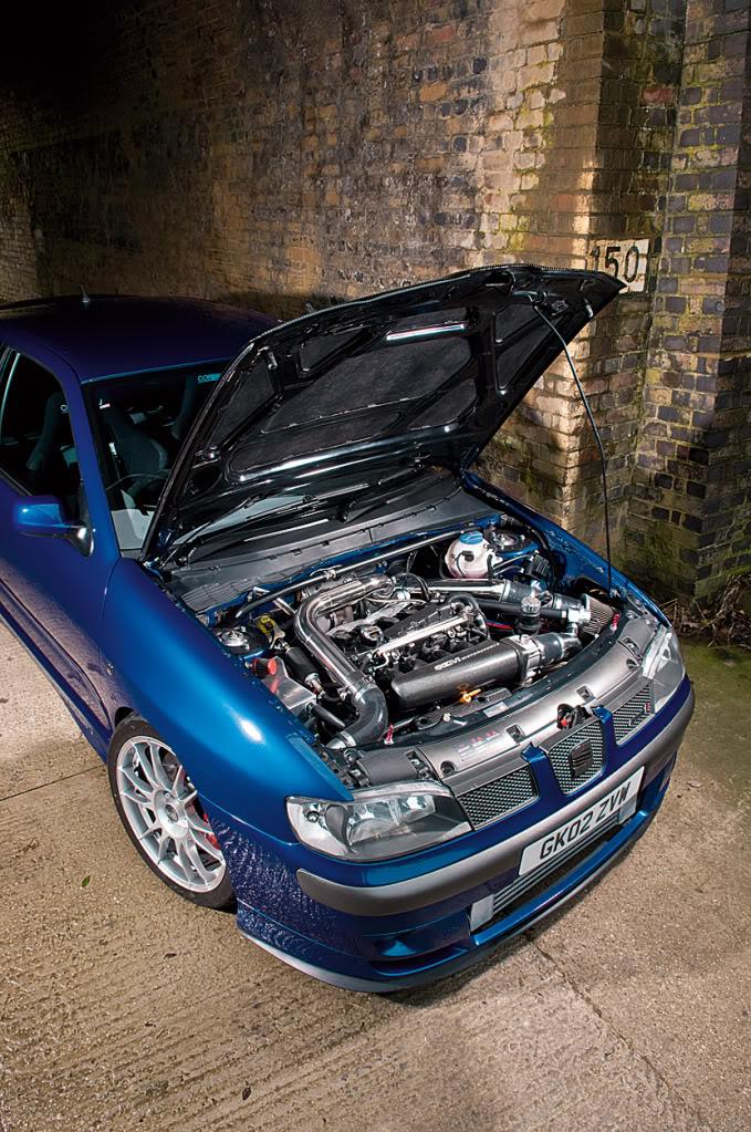

Here is the latest pic of the engine bay.  Still running the K03 at the moment, but I'm in the process of doing a K04 hybrid.  The turbo should be finished by the end of the week hopefully.  The car runs a Revo stage 2+ map.  Its got an APR fuel pump and a Blueflame decat turbo back system.

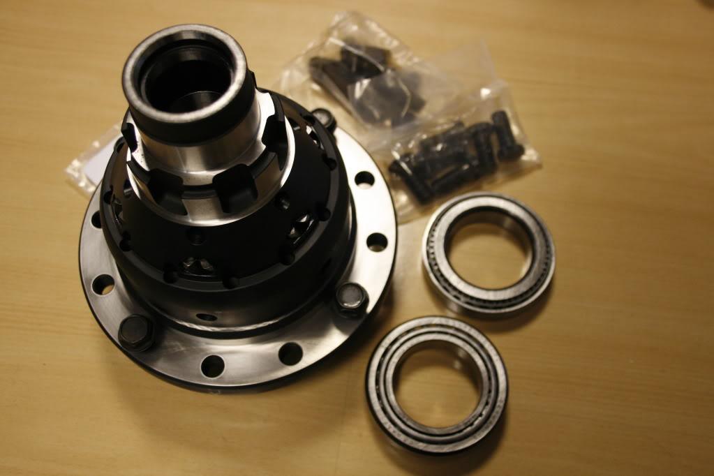

Got this through from Peloquins.  Their new high torque diff.  Its mean to feel more like a plated diff.  I need to get a clutch ordered and I will fit the diff at the same time.
I did use to have a blue Ibiza Cupra.

I used to have a blue ibiza cupra and live near PhilW his is a work of art as your was!
