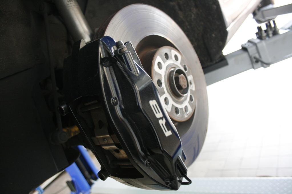

Finally got the R8 calipers fitted:
I think I love them  :love:
I've just had an accident........ :ashamed:

They are on:

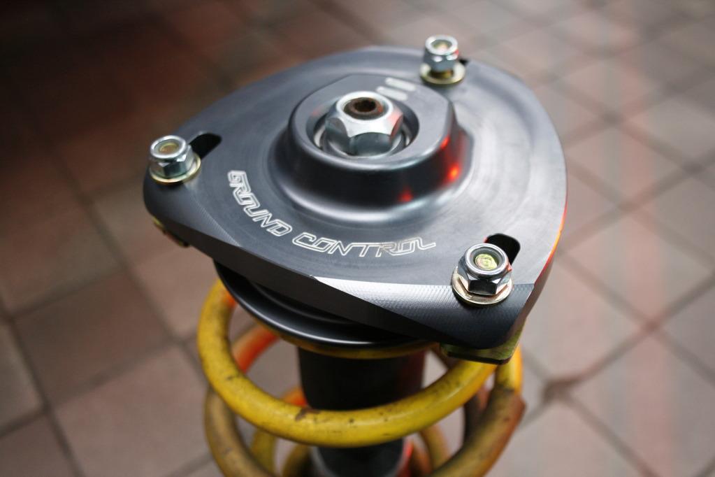

Just amazing.  Transformed the front end and the wheels tuck under the arches perfectly now.  Tad more camber at -3 degs!  Sharper turn in, fantatic in the wet and the KW's are working as they should.  No more annoying rubber top mount bounce.

reckon ground control mounts will solve my clearance issue alex?

reckon ground control mounts will solve my clearance issue alex? been quite bad this weekend :(
They will stop the top mount rubber sagging when you corner which should stop the rubbing.  The stiffness of the coilover is allowing loads of movement in the top mounts.  If I bounced on the front of the car there used to be loads of movement and bounce.  With the new mounts its solid.
Strange that the rubbing has got worse this weekend.  Maybe the heat is allowing you to stop driving like a girl and corner harder with the increased grip.  :signLOL:

They are on:
Do they clunk?
Yes, but not too badly.  That's the only downside with solid top mounts.
