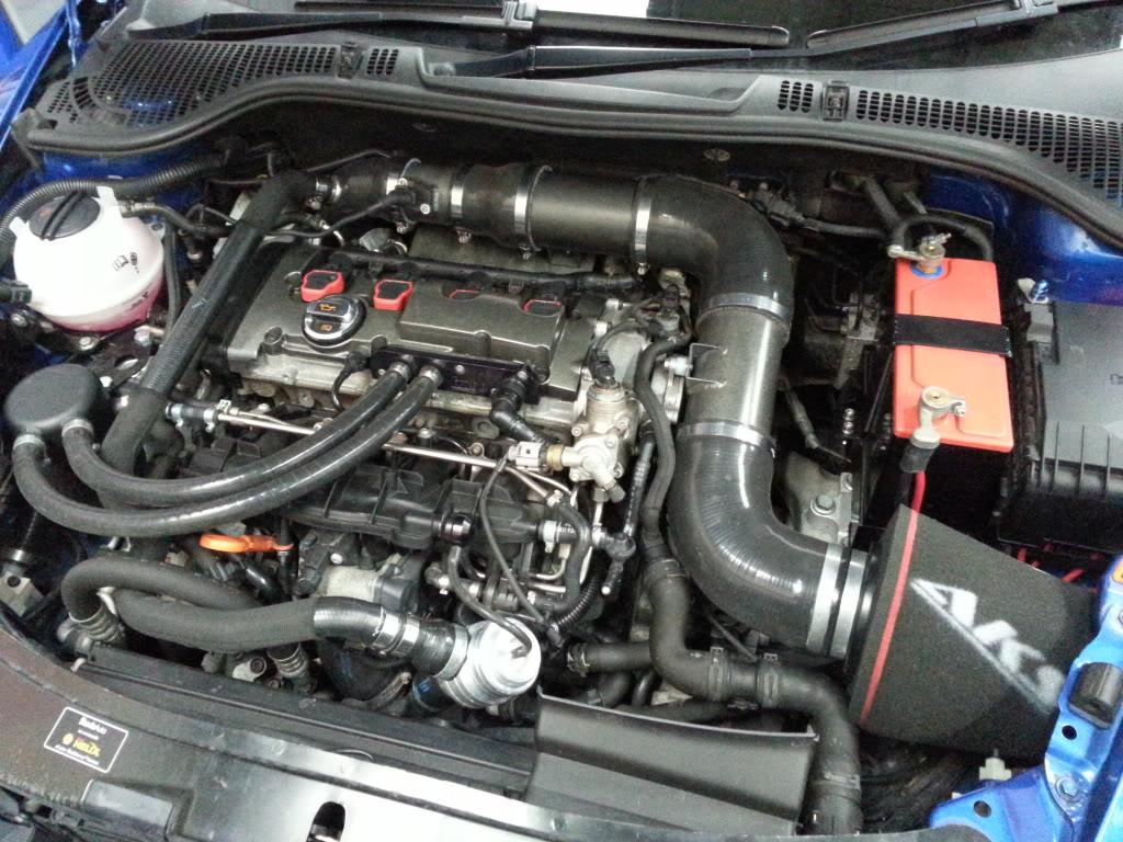

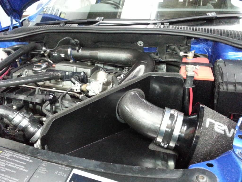

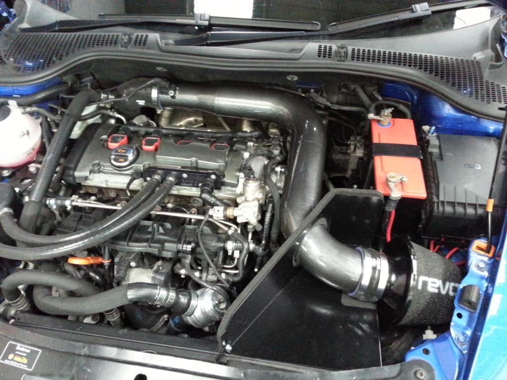

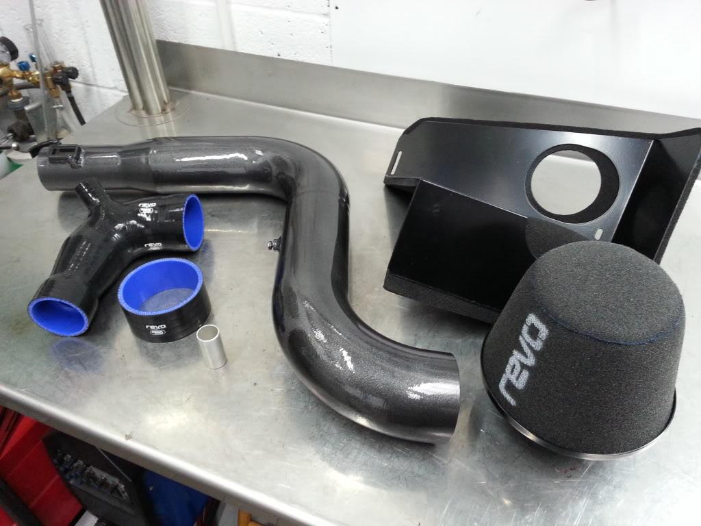

Intake kit change.  Was running the ITG that I copied but ceramic coated.
Before:
New Revo kit:
Fitted:
Overall its improved low down and mid range power.  Holds boost for longer.  Peak maf before and after is identical to the old kit at 275 g/s but peaks higher throughout the rest of the rev range.
Looks and fits great too and to show a gain against the other best kit on the market is good news to me.
Follow AKS tuning on Facebook

Looks good.  Is it loud?  Possibly after an intake but I dont want it to sound lke darth vaders cousin under the bonnet.......
Offline vRSAlex
  • -Receive: 253
  • Posts: 2761
Re: vRSAlex's Octavia vRS Estate - R8 Calipers now on
« Reply #449 on: January 27, 2013, 08:03:30 pm »
Its quieter than the old kit. Still a nice dump noise when letting off the throttle.
Pop over and I can take you out in it.  :happy2:
