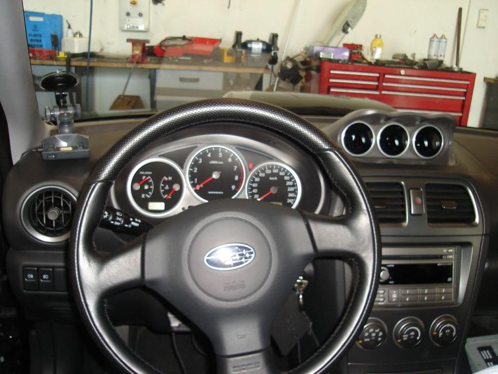

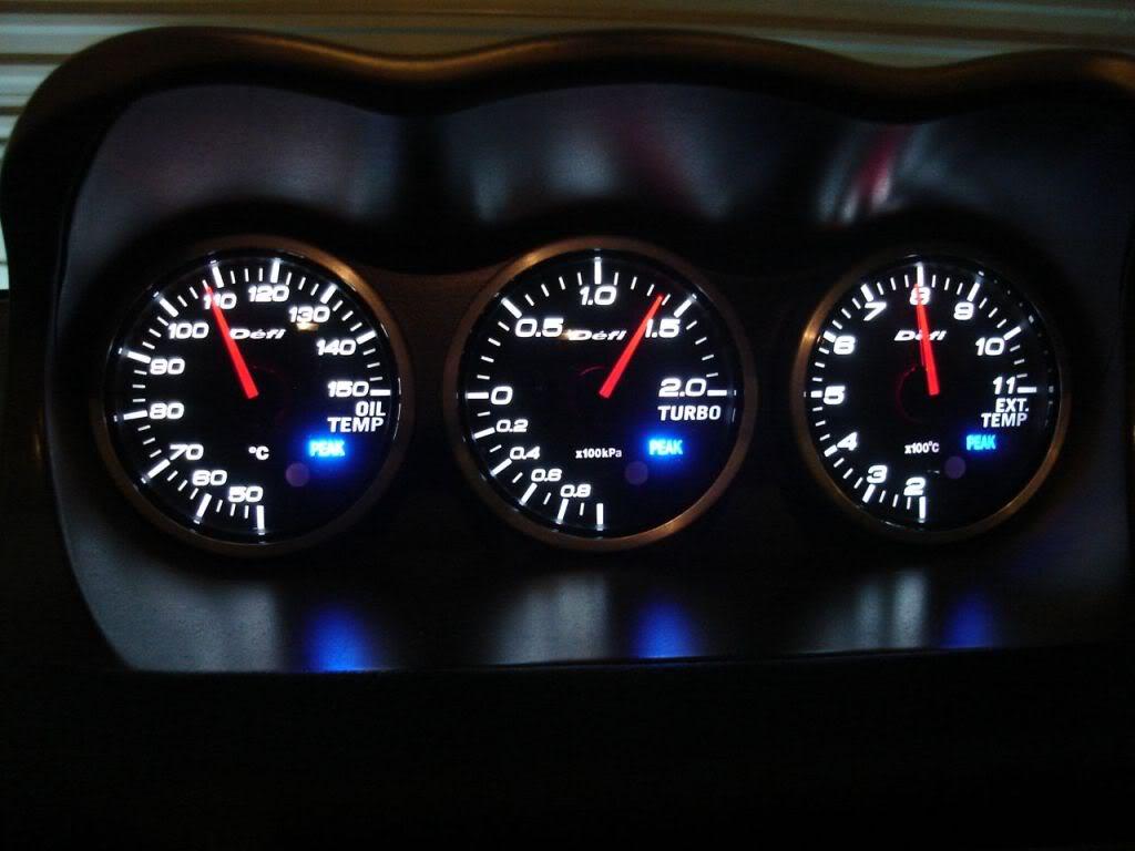

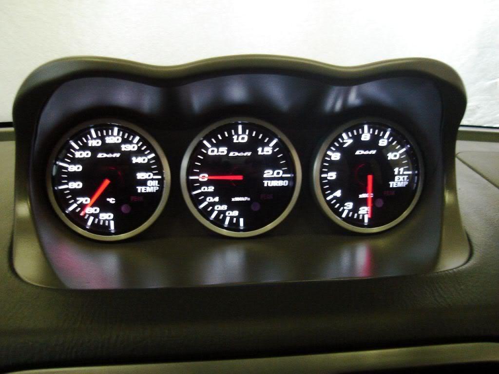

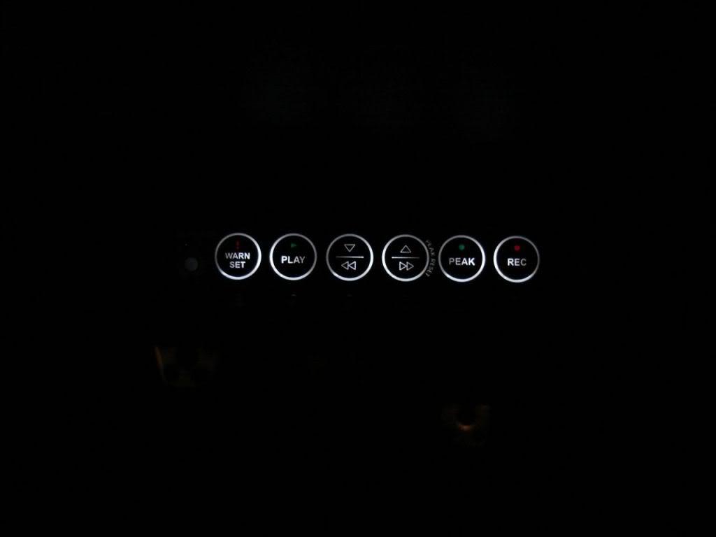

I had Defi meters fitted to my Subaru WRX with the control box fitted, so you could play back your run, you could read peaks, set audible and visual warnings etc... they were excellent.
As you can see they do support metric versions of the clocks. I had exhaust temp (i had the probe in my downpipe), oil temp and boost. I notice that you can get an enclosure that replaces the air vent on the top of the dash, with something like I had for the WRX.
The whole kit is a little expensive, but if you've made some bigger modifications - these are a must.
I had the control unit discretely mounted under the steering wheel.
