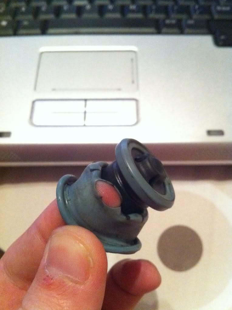

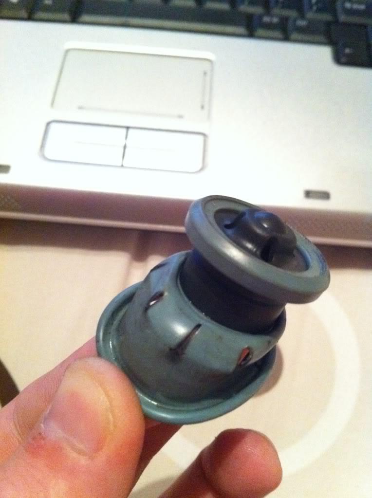

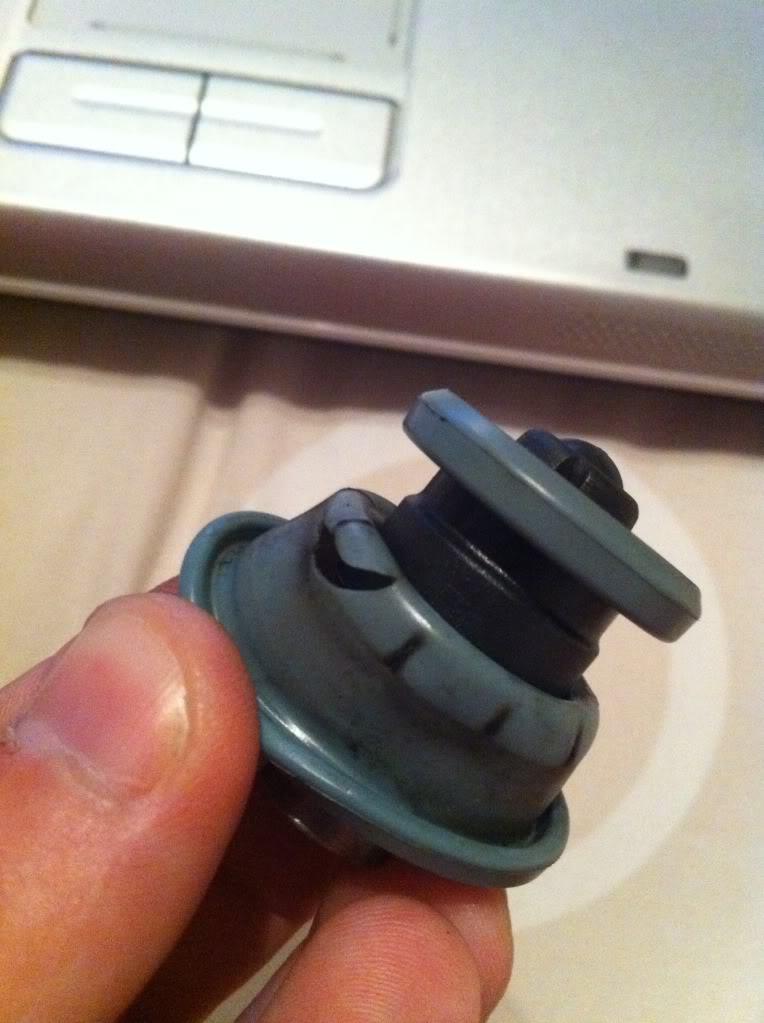

Hi guys, spent the day at Awesome today, had a full service and cambelt etc. Also had the DV changed to the new D version.
The drive home was epic. Before it was changed, when I pressed the accelerator pedal all that really happend was a loud whistle sound, and hardly any boost...
Now the whistle has gone and the car pulls a millions times harder, its like a new car.
The old DV had 5 or 6 holes in it BTW.  :happy2:

Which version was the old one?  Got any pics?

I beleive it was the B vesion which was on the car before (uploading pics now)  :smiley:
Cant beleive the difference from a £50 part  :surprised: The old one obviously wasnt up-to-task.

And that DV is well-fooked! :jumping:  I'm surprised you let it get that bad!  Anyway, the black diaphragm ones were the really early GTI variants, which were about as useful as a chocolate fireguard - yours must be an AXX engine.  The orange diaphragm versions hold up much better.
