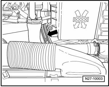

Vehicles with diesel engine:

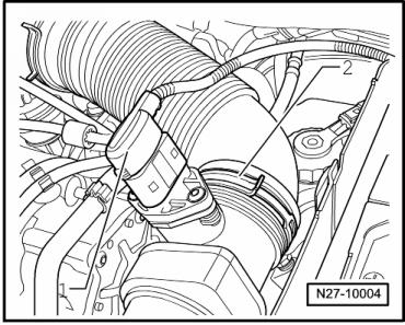

–   Disconnect wiring connector -1- and loosen rear spring-type clip on intake hose.
–   Loosen spring-type clip -arrow- and pull hose off air cleaner housing

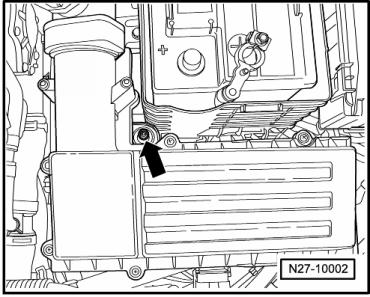

–   Remove securing bolt from air cleaner housing -arrow-.
–   Pull air filter housing upwards out of brackets and remove it.

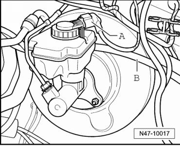

–   Draw off as much brake fluid as possible from brake fluid reservoir using brake filling and bleeding unit -VAS 5234- or extraction unit -V.A.G 1869/4-.
Vehicles with manual gearbox:
–   Clamp clutch master cylinder supply hose -B- with special tool 3094.
–   Pull off feed hose -B- for clutch master cylinder.
Continuation for all vehicles:
–   Pull connector -A- off float warning indicator sender.
–   Separate connector from brake light switch -F- (vehicles as of week 45/05 only).
–   Remove brake fluid reservoir. To do this press locking tabs on the reservoir outwards and simultaneously pull the brake fluid reservoir out of the sealing plugs.

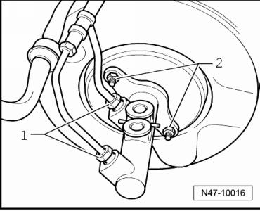

–   Unscrew brake lines -1- from brake master cylinder and seal brake lines with plugs from repair kit Part No. 1H0 698 311 A.
–   Remove nuts -2- on brake master cylinder.

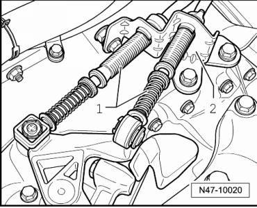

–   Release cable -1-, unbolt support bracket -2- and place it to side → Rep. Gr.34.

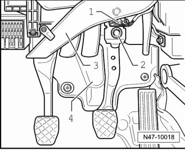

–   Remove trim on driver side → Rep. Gr.70
As of week 45/05, brake light switch is no longer located on mounting bracket.
–   Pull connector -1- off brake light switch.
–   Remove brake light switch -2- by turning 45° to left.
–   Remove air duct -3-.
–   Remove cover -4-.
–   Separate brake pedal from brake servo → Chapter.

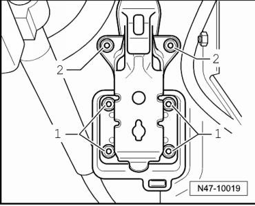

–   Unscrew nuts -1- from brake servo.
–   Remove both upper nuts -2- from bearing bracket.
