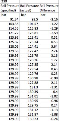

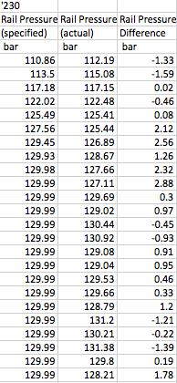

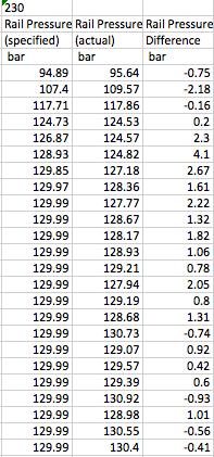

Ahhhh just found these Stage 2+ Logs of mine

so on average your under by 1-2bar there.  also noting that yours is requesting 129.99 peak, the revo logs in post#1 are requesting 132.49 peak, so in that case yours might even be under upto 4 bar as well

Yeah but aren't the logs at the top from K04?
I sure K03 Stage 2+ is meant to top out 129.99

Would the revo still be requesting the same fuel pressure on a ko3 and a ko4????

The rail pressure and HPFP are still limited to the same value.  the only difference between them is the k04 has bigger injectors.
With that in mind i think this makes more sense to do it onthe k03 as the injectors are closer to thier max potential than a k03 car at similar output
