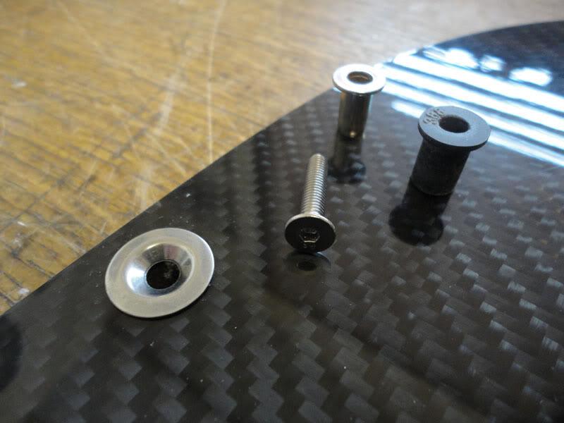

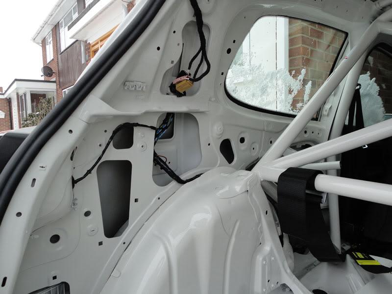

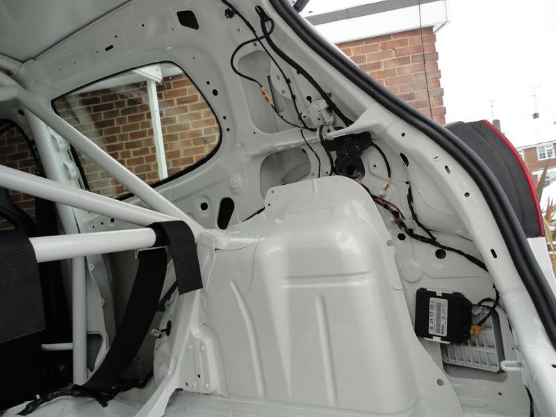

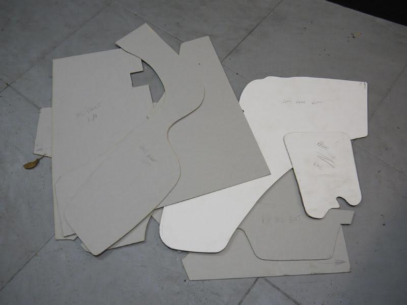

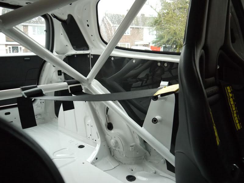

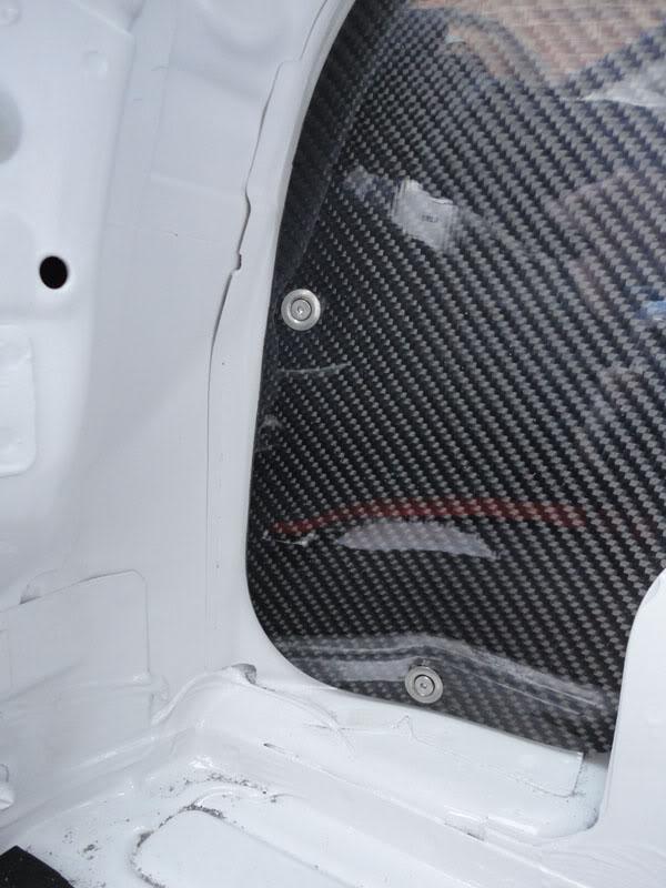

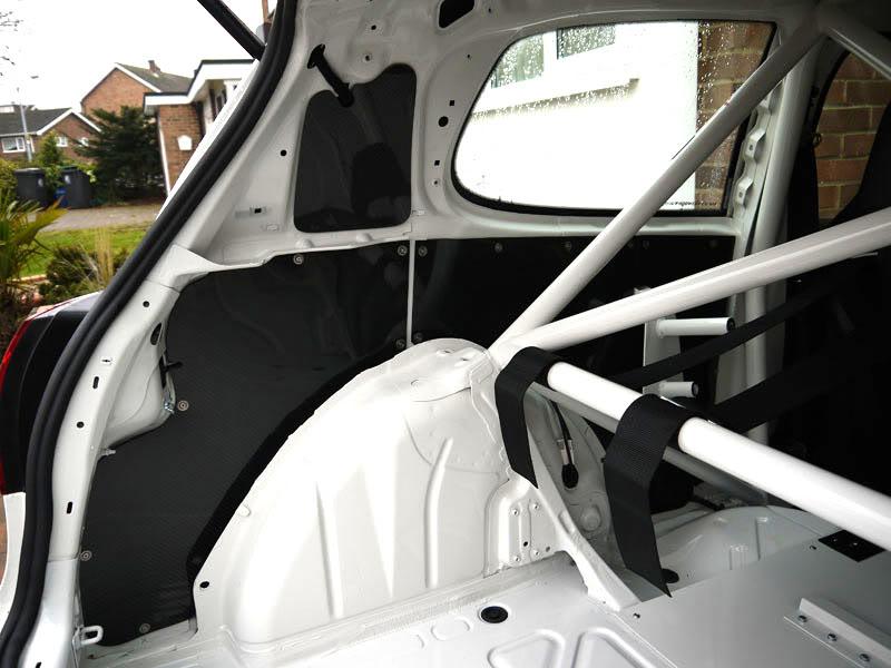

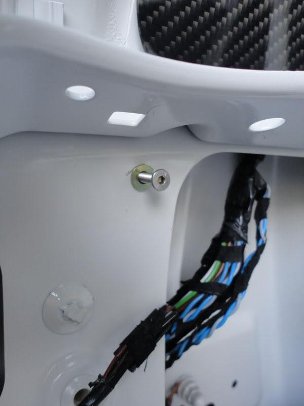

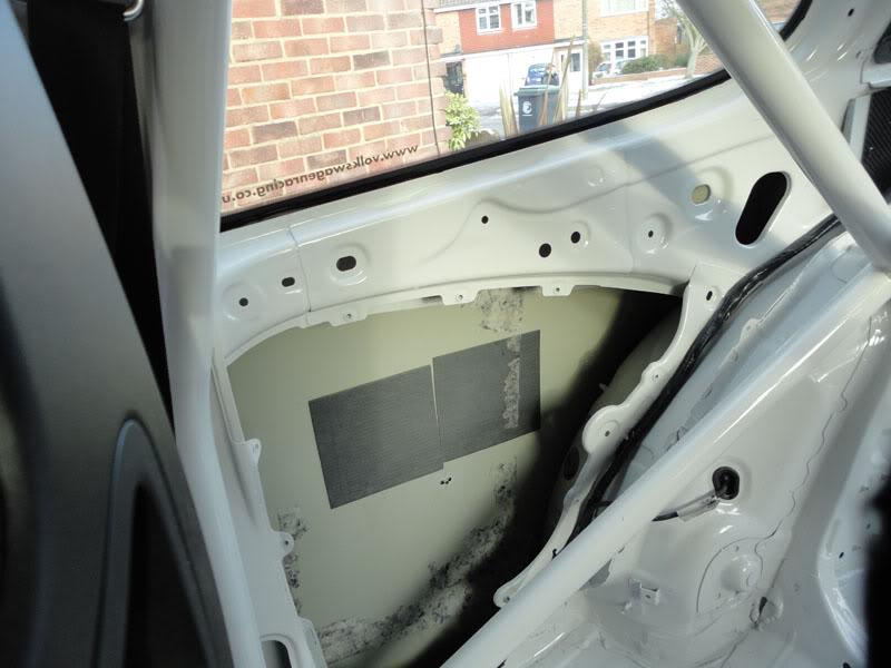

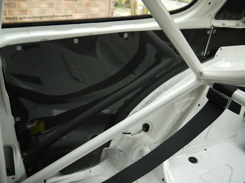

I have cut and fitted some 1mm thick, 2/2 Twill Carbon sheets to tidy up the rear (carbonmods.co.uk).
Big thanks to gazbutS3 for getting me some flush fitting screw caps and reminding me of Rivnut fixings  :happy2:
Managed to do it with 3 no 950mm x 500mm panels although not all the weave is in the same direction, and backed the panels with Neoprene sponge to avoid squeak/rattle.
If any one else has OCD, likes carbon dust, enjoys working in a fridge, wants the templates  :happy2:
