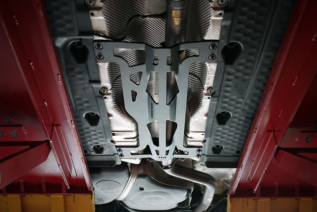

Are you aware of this underfloor brace for the Mk5 GTI?:
Any good in your opinion?
Re: improved aerodynamics with OEM parts
« Reply #7 on: December 22, 2010, 08:50:08 pm »
Silly Q but what does the underfloor brace do?
« Reply #8 on: December 22, 2010, 08:51:54 pm »
....Stiffen. Improve turn-in? But I'm curious if any aerodynamic pro's or con's.
  • My Ride: https://www.mk5golfgti.co.uk/forum/index.php?PHPSESSID=gk6ie8qigmag20b7uqru7lcpaj&/topic,19740.0.html
« Reply #9 on: December 22, 2010, 08:53:45 pm »
Id be VERY surprised if that brace improved the aerodynamics.

Interesting, that does look interesting.  Do you have any empirical detail of the improvements in efficiency or top speed?  The extra protection for the engine bay from the elements in the UK is interesting enough.  The bobbles on the golf balls are designed to help it move cleanly through the air and travel further so I guess they do something similar.
Offline the bruce
  • -Given: 322
  • -Receive: 101
  • Posts: 1591
    • my GTI
« Reply #11 on: December 23, 2010, 06:48:27 am »
Thanx, Robin for the pics. Looks really impressive.  :happy2:
I know the small braces from GT spec, but not this huge one.
Maybe it stiffens the underbody a little bit, but it won't improve aerodynamics.
It can't do any harm. So what's the price?
Yes. The former Audi A2 1.2 TDI 3L had some kind of flat aluminium under its exhaust.
This piece is sadly too small for the very large ''exhaust tunnel'' of the Mk. 5.

That brace will do nowt, Robin. Unless they can prove me wrong..
