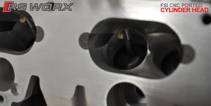

Redline Speed Worx is Proud to Present Fully CNC Machined & Ported FSI Cylinder Heads.
-   INA Engineering CNC Ported / Machined Finished Ports
-   31% Increase in Flow at Intake Valves
-   18% Increase in Flow at Exhaust Valves
-   4 Angle Inlet Valve Machining
-   3 Angle & Radius Exhaust Valve Maching
-   Valves are Lapped into Cylinder Head ( New seats are installed for +1mm Valves )
-   Heads are Ultra Sonic Cleaned Prior to Assembly
-   Ferrea Super Alloy Exhaust Valves
-   Ferrea Intake Valves
-   Ferrea Valve Springs + Ti Retainers
-   Knife Edged Port Divider
-   Intake Runner Divider Slots Deleted
-   INA Engineering CNC Machined Valve with Matching Serial Number to Identify Cylinder Head
-   CAT Stage II Camshafts Available ( 270 / 262 )
-   $3,000.00 ( Includes +1MM Ferrea Valvetrain )
-   CORE Charge $700.00 ( Refunded When a Good Condition Core is Received )

The Ferrea valves are +1mm as well so the valve ports need to be enlarged to accommodate this.
