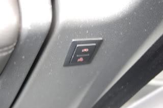

on the bottom of the b-piller on the drivers side theres a button which disables the alarm

^ not strictly true - the button only disables the interior sensors / inclination sensor.  I don't think it disables the door / hatch sensors but I could be wrong.

Thought this wa the anti tow alarm?

oh well worth a try i suppose

Only the alarm kept going off at night a week or so ago and the bonnet light 'Hood Open' message was not being displayed then.  It was going off every couple of hours so quite a long time just long enough to get into deep sleep and be rudely awoken  :sad:  I tried pressing them buttons on the b-pillar but made no difference so come 4:30am and my 3rd rude awakening I just left the bloomin thing unlocked on the driveway in hope someone might steal it...
