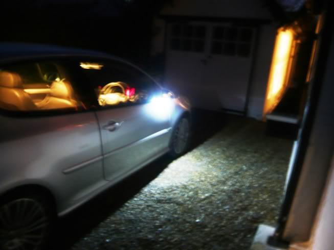

Few things done this weekend, first one was to LED the puddle lights, they are my favourite gadget on the car but I didn't like the yellow light they gave.
First you have to push the mirror right back away from the door to access the allen key hole......
Then you can prize out the puddle section, I just used a butter knife.......
Then pull the bulb out and put the led in. I had to trim the led edges down with a stanley blade to fit it back through the hole !
This was the old bulb
And this is the new one
Really ties in with the xenons now..........

ive got the puddles fitted too f**k me there bright leds, would you mind linking where you got em, wouldnt mind changing mine from yellow to leds. thanks

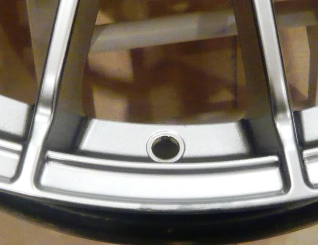

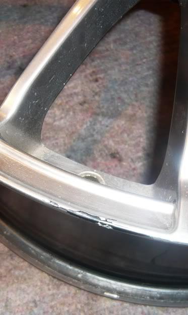

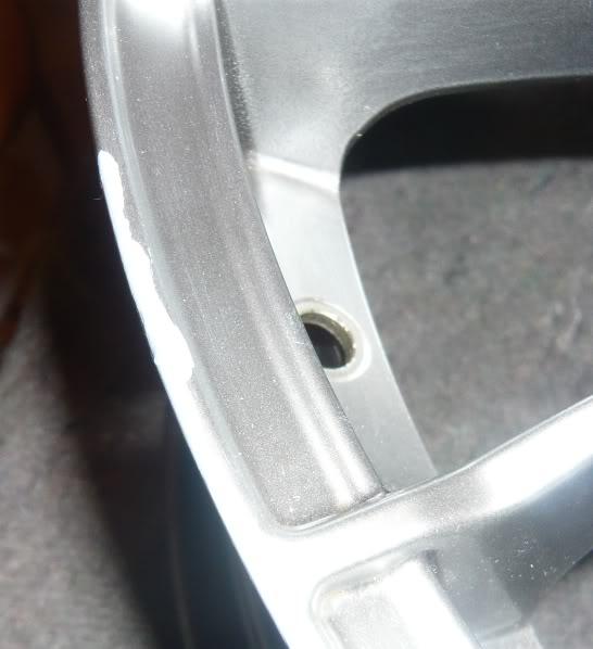

Another job I did was refurb my 19"s this weekend. When I bought them they were in pretty good condition but had 2 or 3 sections of chipped edge on each wheel, time is the problem here as my current Zolders have very worn tyres and need replacing asap ! So just had to do my best and get them ready for the new tyres to fit onto. Here is one as an example :
1 of the problem arears, cleaned up with scratch cleaner (from Paints4U) and tidied up ready to prime.........
primed
3 coats of paint and finished. Not perfect but much much better, up close you can tell but from a metre away you can not see it.
There was about 14 of these little areas to do accross all 4 wheels so they are all done now, so tyres should be fitted today........ Fingers crossed they don't do any additional damage !

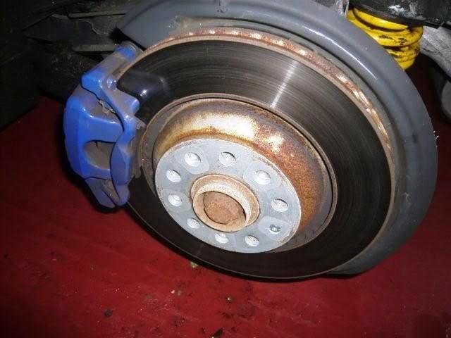

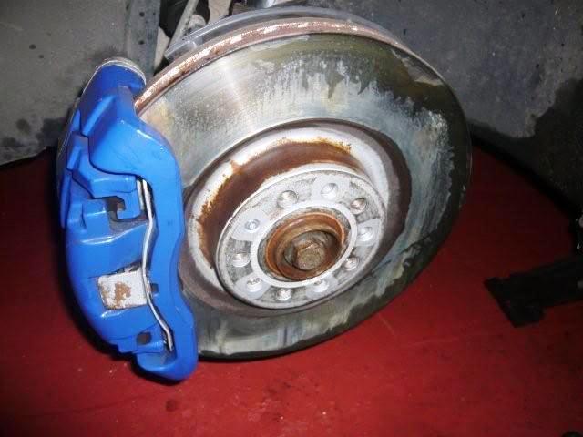

I've also been working on getting everything ready for the 19"s. All 4 hubs had horrible surface rust and the caliper clips on the front looked proper minging, didn't want this showing through my new wheels.
So these have been cleaned up and painted back to silver.......... whilst I was at it I did the little arch liner screw mod  to make sure my new tyres don't rub at all.
Unfortunately the wheel bolts don't fit the new wheels so needed to order up new ones before I can get the wheels on. Hopefully will turn up today.
