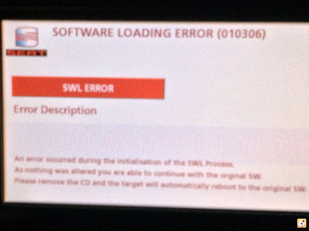

Offline mikeyfraser
  • Posts: 13
Hi I downloaded the software and went to do it and was presented with this.
Anyone able to help me with it?
Offline mikeyfraser
  • Posts: 13
This what I was presented with.
Sent from my iPad using Tapatalk
