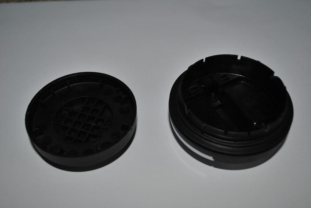

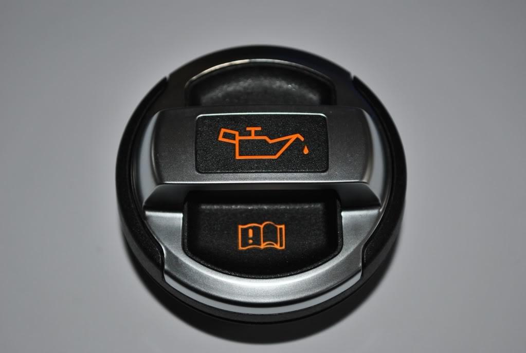

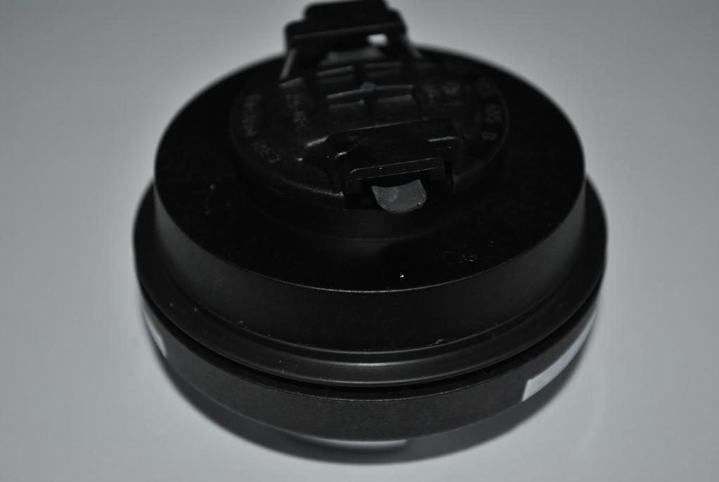

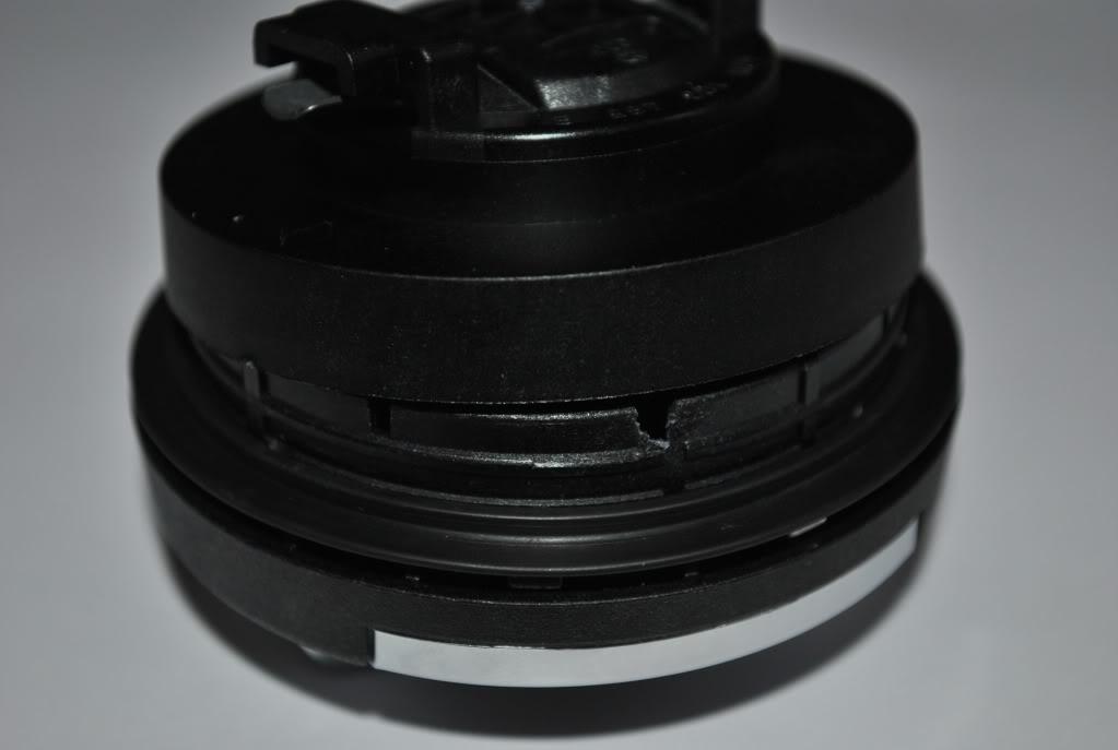

Copied from another site
Quote from: CHRIS555;1083977
Cheers guys!
I've dug mine out and reminded myself how I did it!
Basically turn the cap upside down. There is a very small line running around it (maybe hald a mm or so). You will need to carefully prise this open - I used a flat head screw-driver and did leave some little marks, but once on the car they can not be seen. Prise it open all the way round and then the cap will split into two pieces.
This is where you brain will start to heat up!! There are a number of plastic bits that stick out which ensure you the unit will only click back together one way - basically you will have to figure out at what angle you need to click it together to get the fitting you want then cut some new little gaps for the plastic bit to sit flush in (ignore how I'm saying this, it's obvious when you get the unit open!!!) I used a pair of clipper to cut a few new little gaps and hey presto all done - the unit is simply clicked backed together and job done!
I've took some photos to cover what I've said - when you do this it is pretty simple but it did take me some time to figure out how to open the unit up.
When you lining it on the the oil hole in the block to get the finish you want make sure you cover the hole when not using it to stop muck, dust etc getting in there.
Part Number should anyone need it: 420 103 485 B
Hope this all helps guys
Best wishes
Chris
