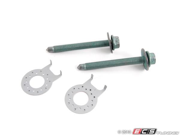

Like a few others on here, I have that knocking noise when steering round corners and when reversing on almost full lock.
Been to the dealers time and time again with no luck to the strange problem.
See this on ECS Tuning and wondered if this would really cure it?
Subframe Spacer Plates
Quote
The subframe knock issue is common amongst the Golf & Jetta V and the Passat B6. If you have taken your vehicle to the dealership but they have not been able to solve the problem, here is your solution.
These bolts and spaces replace the stock bolts that connect your subframe. Over time, the stock bolts stretch and allow slop in the front subframe. Replacing your stock units with identical replacements will only delay the issue and it will reappear after the replacements stretch. Use these Genuine VW/Audi replacement bolts to tighten everything in the front end back up.
Some individuals think that because the stock bolts are designed to break in a front end collision, they should not be replaced.  VW of American has since put out a technical service bulletin to dispell these rumours and replace stock bolts with these units.
Look at the instructional video located on this page to get a better understanding about the installation of this kit.

Good find, Are these VW parts?
If so does anyone the part numbers?

On ecs website it says the parts are Genuine VW/Audi, So may ba able to buy them from the dealer if we can get the part numbers?

Yes they are genuine parts but I bet VW in UK won't do these.
I think I read somewhere that genuine Audi bolts are very simlar to these though (I could be wrong).

I'm going to try my dealer tomorrow - apparently the part numbers are:
Bolt N90823501
Shim 7M3499349A
Offline Jaywoo-GTI

Retail Prices are:
Bolt N90823501 - Doesnt come up.
Shim 7M3499349A - £1.65 + vat each

Bolt size is M12x1.5x110 if it helps.
