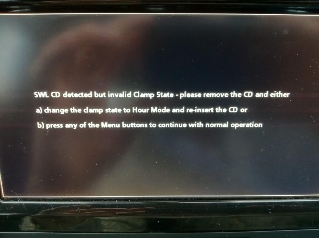

Trying to load firmware, and got this when I put disc in?
What does it mean? What is a clamp state?

Re: Ok What does this mean in Laymans terms? RNS510 Firmware update
« Reply #1 on: January 13, 2011, 01:03:03 pm »
See this thread for VrsCarl :
http://www.mk5golfgti.co.uk/forum/index.php/topic,23779.0.html
Look torwards the bottom of the first first post (a few lines below the photos) where he tells you what to do if you get precisely this error  :happy2:
« Reply #2 on: January 13, 2011, 01:07:43 pm »
As Andrew has just pointed out clock is the wrong format.
see below from my-gti website.
Note: If you receive a clamp state error ‘a swl disk is detected but it is unvalid because of clamp state. please switch clamp state to hour mode and re insert disk’ this means you need to change the time format of the clock in the RNS 510 from 12 hour to 24 hour clock.
only took a quick search and 3 words in google  :happy2:

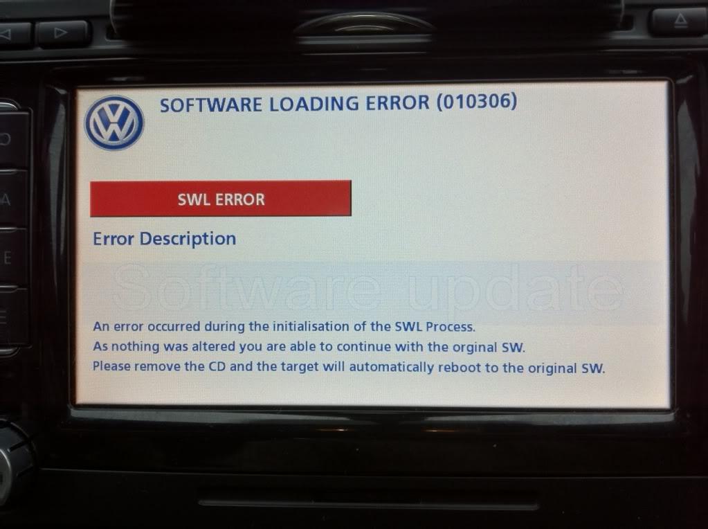

ok but now I have this.......
What now, oohh and I have googled this one, nothing much coming up

Re: Ok What does this mean ERROR 010306? RNS510 Firmware update
« Reply #4 on: January 13, 2011, 02:34:11 pm »
which firmware are you trying to load and what unit, as could be a number of reasons.
« Reply #5 on: January 13, 2011, 03:57:16 pm »
I believe Colin has 2680 and I have sent him firmware 2720 which I used on my RNS510???
Offline vRS Carl
  • -Given: 282
  • -Receive: 241
  • Posts: 3088
« Reply #6 on: January 13, 2011, 04:02:33 pm »
The only time i have seen that happen is when someone has tried to put the wrong firmware on a unit. (Trying to load 1100 on a A revision unit)
Has the 2720 been modified in any way?
The quick solution would be to download the 276X firmware i have linked in the tutorial thread. :happy2:
« Reply #7 on: January 13, 2011, 04:06:27 pm »
RNS510 Version C
VW2720 Firmware
« Reply #10 on: January 13, 2011, 04:29:38 pm »
As i said earlier try using 276X firmware.
