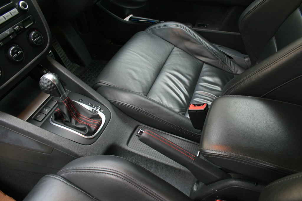

The end result:
Actually, I left a note on my flickr image page about the procedure :P
Quote from: me
put in neutral, lift up the plastic, disconnect the cable, remove the retention bracket (bottom plastic piece so it slides up) and then give it a good yank upwards. The new one then just slots straight on.
