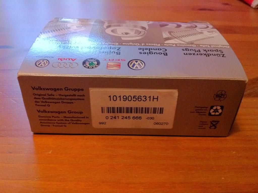

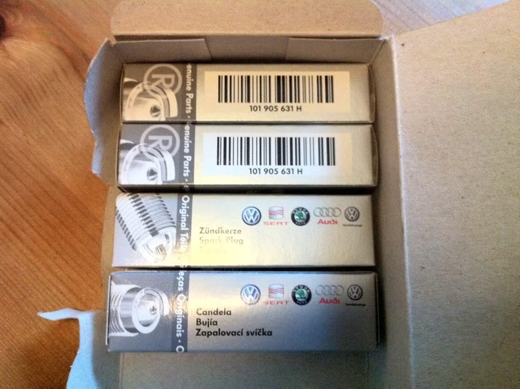

OEM Plugs for all 2.0 TFSi engines is - 101 905 631 H - Bosch Longlife Plugs :happy2:
Carl, my ETKA seams to say 06H 905 611 Longlife plugs (AXX, BWA, BPY, BYD)...
Offline vRS Carl
  • -Given: 282
  • -Receive: 241
  • Posts: 3088
Re: Spark Plug issues
« Reply #16 on: February 05, 2011, 02:15:11 pm »
They are Longlife plugs whereas the ones i listed are Bosch Longlife ones.
The Bosch are the latest plugs they sell ( i bought mine about 3 weeks ago )
Offline Beddie
  • -Receive: 76
  • Posts: 1303
« Reply #17 on: February 05, 2011, 02:17:11 pm »
Just picked up the '30 from having its 45K and DSG services, invoice for the plug change has the 101 905 631H part number listed, £44.64 for 4  :happy2:

« Reply #18 on: February 05, 2011, 02:22:42 pm »
Just to show i'm not going mental  :smiley:
