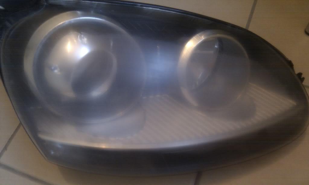

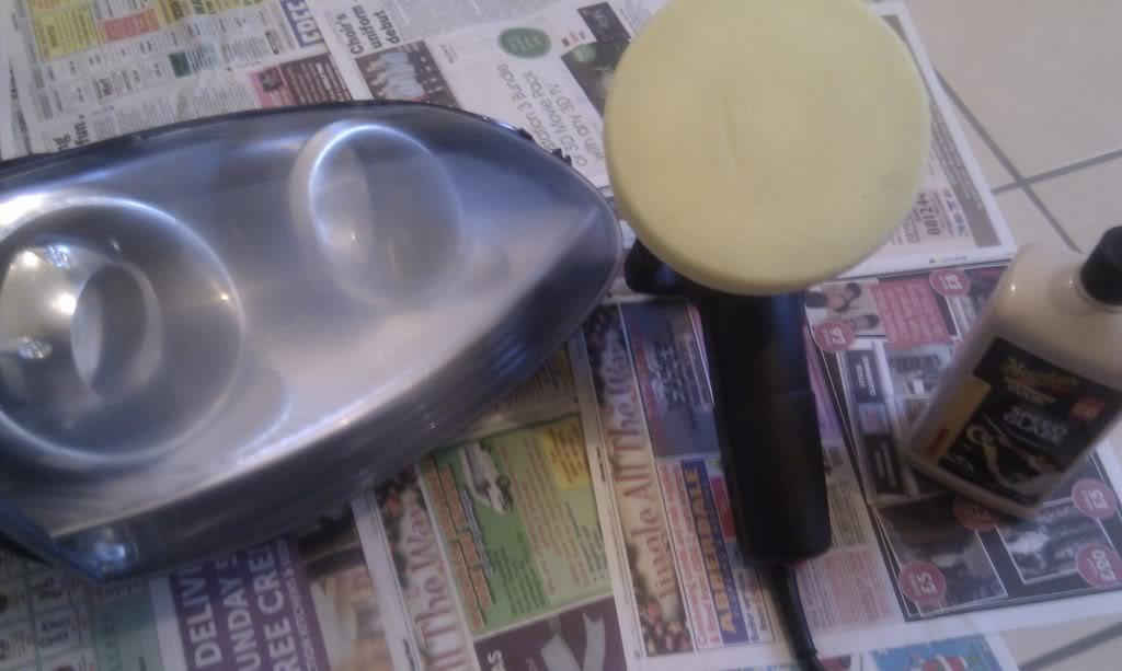

6. Depending on your preference use a machine polisher and pad, or get your Plastx, Autosol or similar out and apply to the headlamp with your microfibre. You will need to really work at this to remove the fine scratches left from your final grade of wet and dry sandpaper. Again the more work you put into this, the better the results.
You should then be left with something like this:

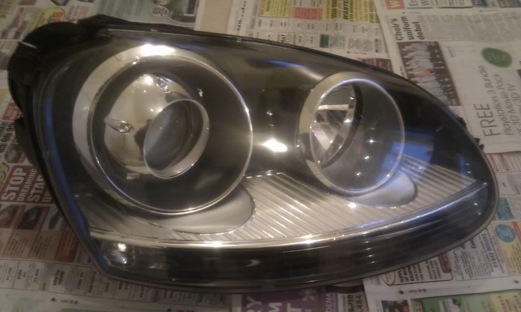

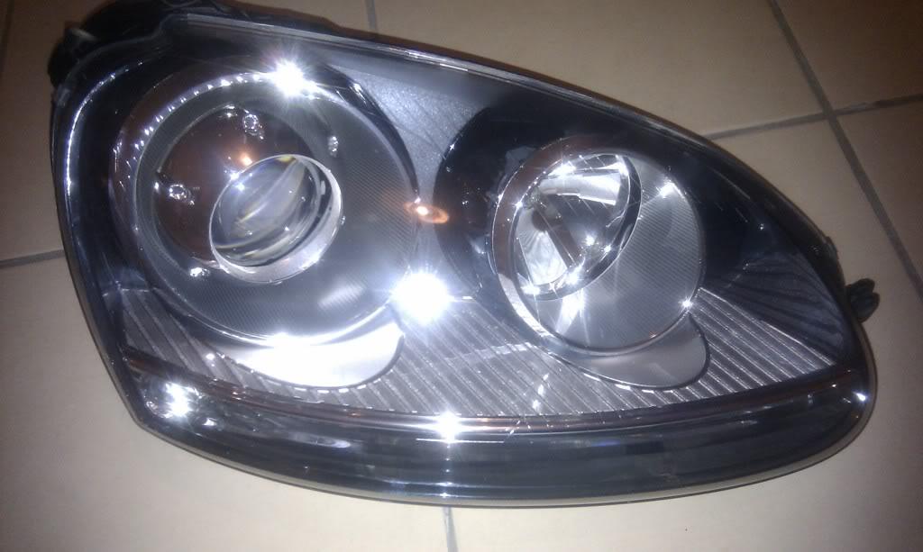

And after some more work the finished headlamp:

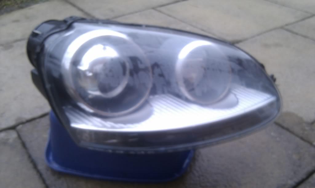

The only other image I have is this one below. Forgive the quality of the image, but below you can see, in the left hand corner, three really deep scratches that were completely removed.
