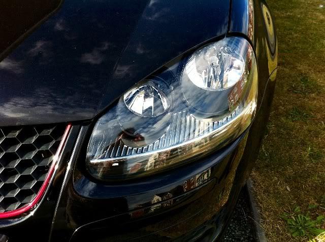

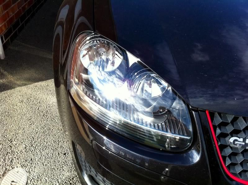

Cheers for the guide.  I had a go at mine 2 weeks ago with 2000 grit but without enough of it and I ended up with an outer ring where the old plastic met the new plastic.  This cannot be rushed.  I then ordered a sheet of 1500, 2000, 2500 and 3000 and had another go at fixing the light in the week.
It probably took almost 2 hours per light but the result blew me away, especially after i thought i'd wrecked the light.  Initially i was just going to do the one, after i'd seen the difference you could actually see they were a different colour so had no choice but to continue and do the other today :laugh:  Mine were pretty pitted  and covered in scratches for some reason but everything was removed with this process.
I did try polishing the lights by hand with plast x as my neighbour had my machine polisher.  After 3 hits i could see I was never going to get the sanding marks out.  I then got my machine polisher and menzerna intensive polish and they were perfect in 2 hits.  To anyone worried about attempting this, you just need patience!  Well worth it in the end, and don't do it unless you have access to a machine polisher!!
Some iPhone pics so not perfect but you get the idea
