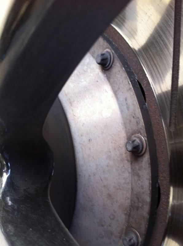

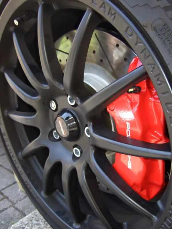

Would u like a pic of my Vwr setup of the clearance I have with the bells and the pro race wheels that is what the race cars are on
Yes, that would be great, thank you.
Re: Spacers on the track?
« Reply #5 on: March 21, 2011, 09:09:07 am »
not much room  :signLOL:
dont forget these are non built in spacer bells  :happy2:

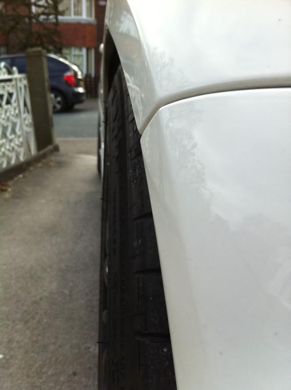

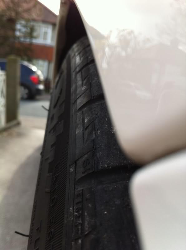

« Reply #7 on: March 21, 2011, 09:19:46 am »
Likewise on mine Matt - not much space (circa 2mm), but enough (not the best of pics but you get the idea)

« Reply #10 on: March 21, 2011, 09:46:49 am »
They are Porsche 4pots off a 996 Turbo, running on 18*8 TD 1.2's ET45 - more pics on my buidl thread
« Reply #11 on: March 21, 2011, 09:49:41 am »
no mate no rubbing at all no matter how hard you try  :smiley:
