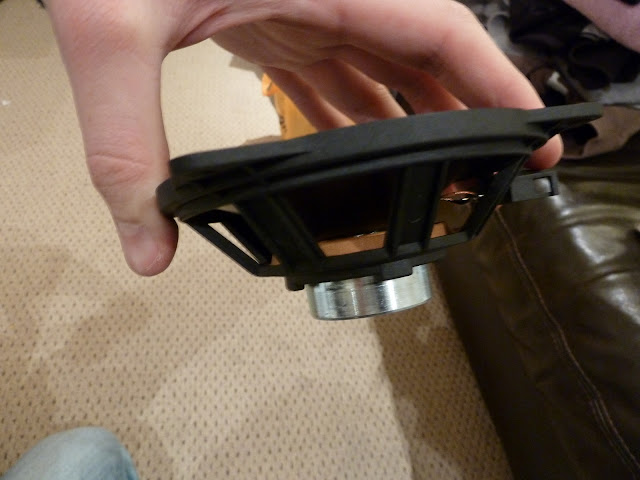

Visually they look well put together and the woofer has some decent weight to it and a good range of movement on the cone, the woofer plastic housing is also formed as the outer shell of the speaker and the base of this has foam padding to cushion between the plastic and the metal of the door ensuring a tight and cushioned fit.
The Mid range speakers have the  same polypropolene plastic cone and have a sturdy ABS plastic shell not much more to say about these without an original speaker to compare.

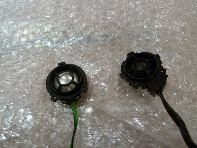

The tweeters appear to be well put together and have a suprising weight for there size and what looks to be an in-line noise supressor or frequency filter, the kit includes double sided foam pad for the fitment of these into the original position.
I also tried to use the hoover technik mentioned by Creatz to rectify the slight crushed tweeter either my hoover isnt powerful enough or the aluminium cone wont reform easily either way I will install and see if the damage interferes with the sound, if not since each item has its own item number I assume I can simply order a new tweeter unit on its own!

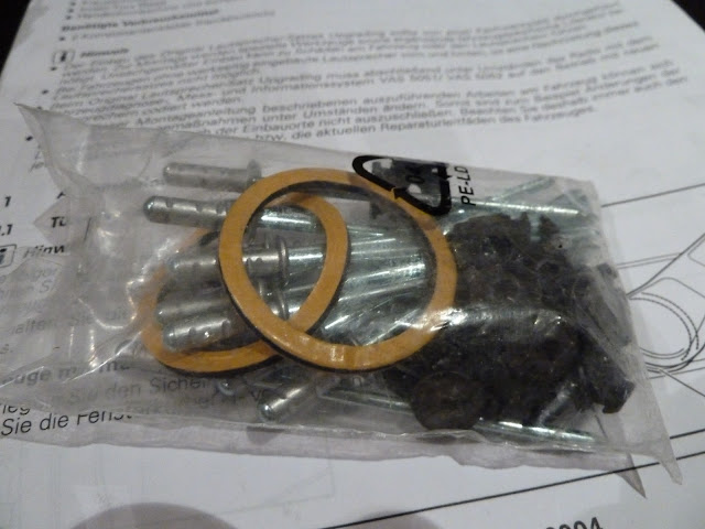

The kit also includes a full fitting kit including dlind rivets for the woofer screws and backing plates for the mid range and foam pad for the tweeter as well as a comprehensive fitting instruction manual.

Right well after a long day at work I decided to take on the task of replacing the speakers! And it was a mission.  :sad1:  It all would have been alot easier but the rivets didnt come out cleanly and I was left with 6 rivet nubs which wouldnt come out without a lot of persuasion with some pliers crimper tool and a hammer  :scared:

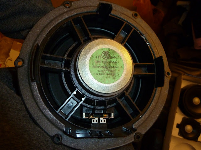

some comparison pics, I tried a video but the mic on my camera wasnt able to deal with the volume.
The old mid range and woofer were both 4ohm speakers the new is 8ohm this increase reduces the load on the RNS amplifier.
Old and new tweeter both 4ohm
new midrange side
old midrange side

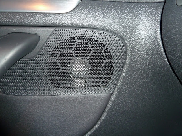

Also forgot to mention that it will also add some subtle extra eye candy for those with eagle eyes....
you can see the silver cones through the grills!  :pomppomp:
