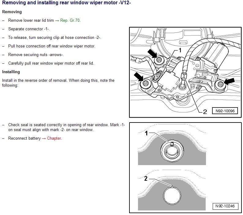

it will just be a matter of taking the motor out and filling the hole in the glass with a black rubber grommet. can get them from b&q etc

Then grommet with silicone sealant too and then cover the screen in RainX

I took mine off to do the boot latch replacement. Getting the wiper and motor off is easy, getting the boot trim back on and aligning all the metal clips tests you powers of patience a little :innocent:
