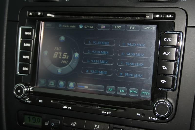

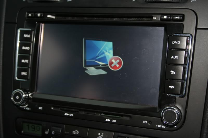

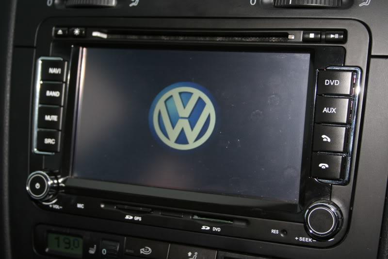

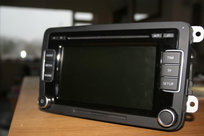

Just joined up, bought a GTi yesterday and while the dealer was showing us the bits and peices, he went to turn the Satnav on, and nothing.  Nothing happened.   After a few attempts, we managed to get it to come on, but 5 seconds later, turns itself back off again.
We were informed that the unit is not a genuine item, and after a bit of digging, i've found that there are many companies who make an OE look piece.   So can you help me identify it?

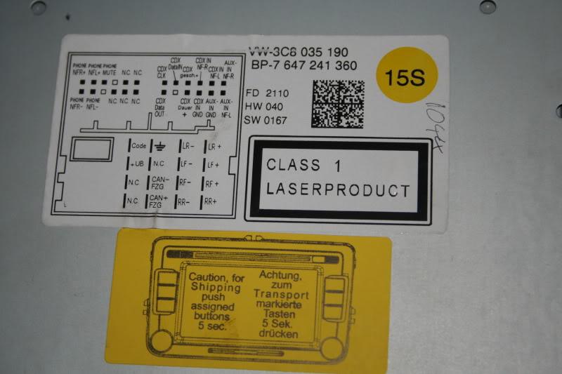

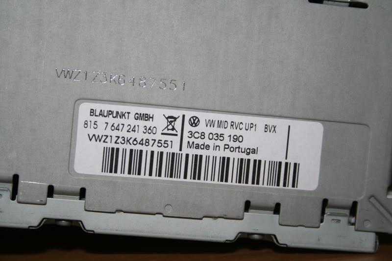

As a good will gesture, the garage gave me a 6CD touch screen unit which i believe is out of a mk6.   Another question i have, is will this be ok in my 55 plate golf?  I have read about some Gateway item which may need to be changed to prevent the battery from draining.   Here are some pics and part numbers of that unit....
Any help would be very much welcomed!  :happy2:

Reload the maps on the SD card again on the old unit. Format it on PC and put the software on.
Look on eBay theres a few ask them what nav they use and download it, they are all based on the same software so ask anyone selling a replica of the original units.
Should work ;)
Alternatively ask apollo13, he had a replica unit and might know the name of the nav software ;)

As for the new unit, being an RCD510, there is a good chance you will have problems using that in a 55 plate golf with regard to battery drain. If its a VW dealer, I would have said you should demand an RNS510 and a new can gateway as its not your fault its got an imitation HU

Have you tried pressign the tiny little reset button on the front?
If it was me I would whip that after market unit out get a new gateway and put the RCD510 in will add value to the car!  As said worth telling the garage you cant use there good will gesture without a replacement gateway if they managed to source and RCD510 easily enough they should be able to get and fit a gateway for you.
Offline Spikey
  • Posts: 21
Thanks for all the responses guys, really appreciate it.
@Betty - I am just writing an email to that company off ebay to see if they can identify my problem with the aftermarket unit.   Hopefully they will have enough experience to help.
@ Alex - I doubt they'd give me a RNS510 as the car was never advertised to have satnav as it was an aftermarket unit.   I don't see why they shouldn't give me a new can gateway mind.
@ Rich - I have tried the rest button a fair amount of times.  When pressed, the source button lights up but nothing else happens.  Tried many different sequences of buttons to try and make it work.

Hi I had one similar to this and had NO problems with it whatsoever!(But I know many that have)
I actually sold it to another member and he hasn't either.
The software on it was Igo8 and to be honest the nav knocked spots off my RNS510.

So is there anyway i can check to see which gateway i have and if it would be compatible with the RCD510?  There is always a chance the gateway has been upgraded by the previous owner.
Is there anyway i can tell if the battery is in fact draining if i were to install the RCD510?   We are getting very bored of a lack of music in the car!  :indifferent:
Offline alexperkins
  • -Receive: 99
  • Posts: 2122
VCDS is the quickest way to check. I am actually up your way tomorrow morning - have to go to winchester if you fancy meeting up. PM me  :happy2:
Can even help you swap it and code it in  :smiley:
The only way to tell is to install it and see what happens. Often guranteed if its below a K that youll end up with a battery drain unfortunately. Though, it does depend what software version the unit is running (out of a mk6 golf will be the later ones though)
