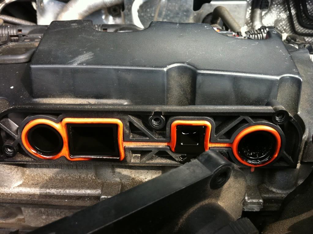

woke up to set off to awesome and exhaust light was on
got to awesome plugged bluefin for fault code, the car then had a paddy, immobilised itself, wouldnt start or turn over or anything
got the standard map uploaded and started, then got the stage 2 map on and took it out for half hour, was boosting as standard and boosting different in every gear, 1st and 2nd was struggling to boost at all, 3 was maxing out at 10psi, 4th 12 psi and 5th and 6th maxing out at about 16psi
had it out for a few miles with it obviosuly still been in learning mode but nothing was changing.
Decided to stick it on the rollers anyway but wasnt expecting good figures or anything near what i should have been getting, this was proved right when it went on
best run was 233.7 bhp and 333.48 ft/lb torque
was expecting between 250/260 but i knew it wasnt running right

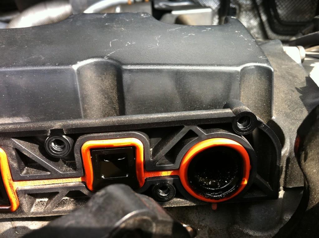

spoke to awesome and they suggested it could be the pvc system as they are a known weak spot on these engines
so got back to r lasses engine cover off quick check to see if i cud see anything, nothing much tbh
few bits of debree in end tunnel so cleaned that out
so now i need to contact bluefine to double check the map, will send them the print out etc and ask why the boost is so unpredicatble
so the continues to give me grief lol
drives fine, smooth etc and no problems, just not producing the power it should be

looks like the Orange O ring has been leaking gases, in the 1st photo, also looks like oil staining on the cylinder head... or its a dark shadow?
New PCV kit i would suggest. O ring gasket is a seperate part im sure.
In-expensive to replace, would suggest if you havent changed it before, to replace it as its off.
« Last Edit: May 09, 2011, 10:48:49 am by Saint Steve »

« Reply #9 on: May 09, 2011, 11:01:13 am »
nah it hasnt been changed before, i will order that from vw today and try and sort out an after market pcv fix for the car too if i can
awesome suggested the euro jet one,
also thats just a shadow but i can see how you thought it was leaking.
hopefully the update should help it run better and boost better cheers
