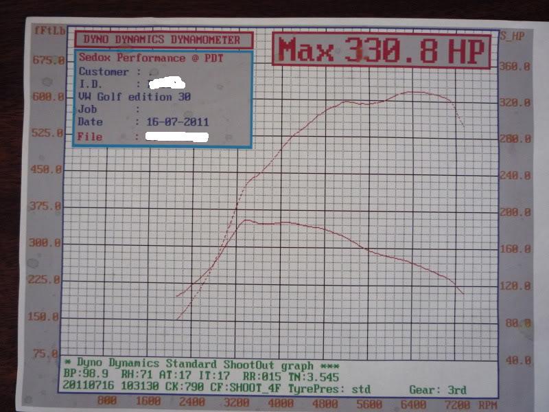

I made an extra 18 bhp 5 weeks ago on the same rolling road :confused: :confused:
This time there was a strange dip at 5000rpmcompared to last time :surprised:

Im pretty sure that dip is caused by timing pull Dom.

Why does it timing pull only show as a dip, not a total reduction from then till the redline?

Rich, its because the ECU has pulled some timing out because it didn't like something. Once the ECU was happy again it stops retarding the timing and releses more power..

Found a spot of timing pull when I logged it today  -9!!!!!!!!!  :scared: :scared: :scared: :scared:
