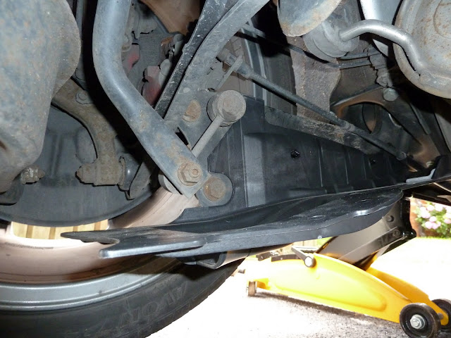

So yesterday I gave the car a service oil and filter plus air filter in general its was fairly easy as said only thing I would say was getting the oil filter out and releasing the pressure without any thing designed for the job was a little messy especially when everything is only a foot or less away from your face!  It was alsot he first time taking the engine cover off and I was suprised how easy it was think I had built it up in my mind to be a nightmare that always ends in a broken cover!  :signLOL:  It was interesting to see all the gubbings in the engine in more detail once all the plastic was gone and I was thinking the under-side of the air box was screaming out for some heat reflective tape to at least slow the ingress of heat.
and after/during I also fitted the aero parts, it was all relatively easy only issue I had was not being able to get the car too far off the ground, I also found the rear grit guards very tight to get on.

The rear grit guards were interesting to fit the trailing arm on my rear suspension (if that is the right term for it) had an extra downward nodule on it which meant I had to get under the car and really tugg on the plastic to force it along to locate the plastic rivets, I also didnt need to relocate the brake cables as they sat along the top side of the arm and I couldnt see that these additions would cause them to foul at all.

The front panel the lumps and all the fitting bits were readily available from VW, the stone guards for the rear suspension are A3 TT only so only from Audi (so the VW told me) and the rear axle guard I have to wait for despite them having all the fitting bits in stock.
