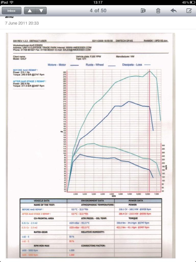

« Reply #30 on: June 08, 2011, 12:51:37 pm »
This is JK's RR at stage 2 with an AMD map
« Last Edit: June 08, 2011, 01:28:12 pm by Jussa »

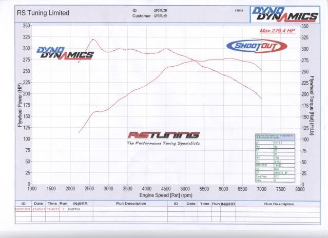

« Reply #31 on: June 08, 2011, 12:53:05 pm »
And this is mine at Stage 2+

« Reply #32 on: June 08, 2011, 01:31:13 pm »
Awaiting PDT and Janner feedback  :fighting:
Offline Jussa
  • Posts: 1051
  • Bicester
Re: Forge twintercooler
« Reply #33 on: June 08, 2011, 01:42:06 pm »
 :popcornsoda:
Interesting reading considering JK has no HPFP or intercooler and I do......same map, same rollers  :confused:
« Reply #34 on: June 08, 2011, 02:01:45 pm »
Awaiting PDT and Janner feedback >>>:fighting:<<<
Am i misinterpreting that !!!
:popcornsoda:
the curve looks really good in all honesty,  I dont think you can compare the two graphs either as AMDs rollers give really inconsistent results out all the time.  as said earlier, yours could be 100% fine and giving realistic figures, and JK911 judging by his before and after plots is over reading by 15Hp so me personally id say he only has 267hp which in itself is still very good for a stage 2 K03.
The biggest tell tale for faults is to get it logged with VCDS
Personally  I still think you should try another set of rollers and if the car makes the same figures as you have now, or comparable to other dyno dynamics rollers then you'll know its OK.  I just thin you could end up going down a rabbit hole looking for issues that might not actually be present

« Reply #35 on: June 08, 2011, 02:24:51 pm »
Janner,
Are you saying that a stage 2+ should only be 280bhp and 320lbs/ft torque?  :surprised:
« Reply #36 on: June 08, 2011, 02:38:21 pm »
yes, and Im sure theres half a forum of guys on here who will back that up.  The only way you will make more is by going to generous rollers.
Heres what stage 2+ cars make on rolling roads in which stock cars make stock figures.  FWIW robert on here with his stage 2 thought he had 280hp+ but when using JKMs rollers found he was slightly behind the revo guys
