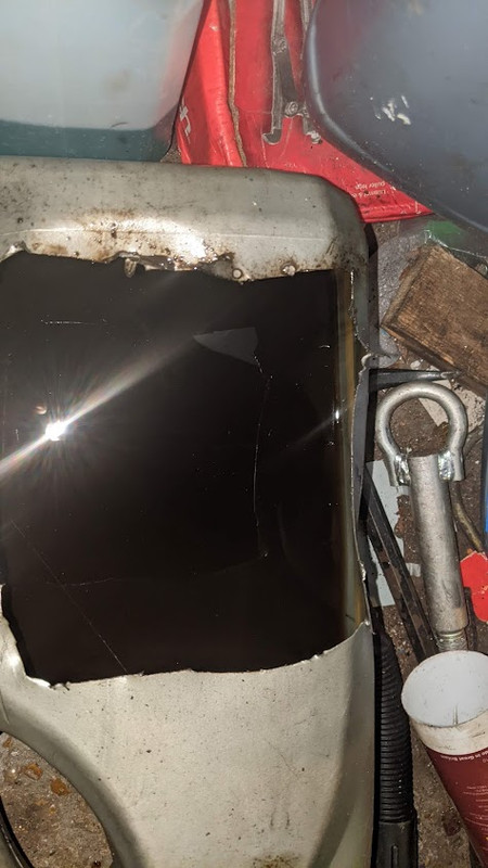

Finally got ronnd to swappiing out the semi synth gerbox oil I put in before Xmas as a temporary fill to help clear out any residual muck. Very surprised at how mucky this is as I can't have done more than 1000 miles since the change.  Have noticed an immeidiate improvement im notchiness when shifting whilst the gearbox is still cold and it also feels smoother.  I used fully synthetic Comma 75/90 and about 00ml Triple QX nano additiive.
This time I jacked it up from the drivers side, loosened the fill bolt first before removing the drain bolt and leaving it drain for a couple of hours whilst I cooked dinner. Then came back to fill from the top using a short piece of garden hose to faciliate.  I didn't use the special VW tool, I used mole grips to release the drain and fill bolt when clamped and then a tap with a rubber headed mallet.  The image shows the oil drained from the gearbox, almost as dark as the used engine oil just not as thick. Mileage is about 135k

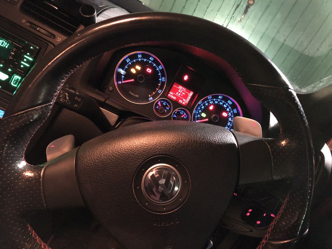

Replaced my DSG paddles with ones from a Seat Ibiza Cupra…
They’re a direct swap and more tactile to use. Got the paddles from a cheap wheel off eBay. I like the OEM look and they’re easier to reach, if not as good as the full aftermarket extensions. Less than £30 all in and done in 45mins.

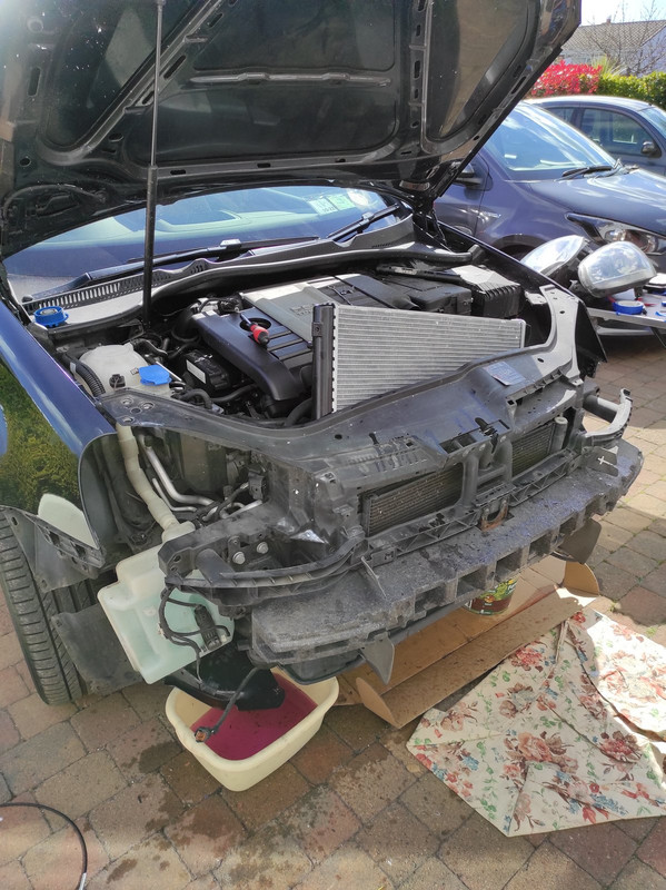

Finally swapped out my leaking radiator for the new one  :happy2:
Hardest part as not breaking the 15 year old plastic clips!
