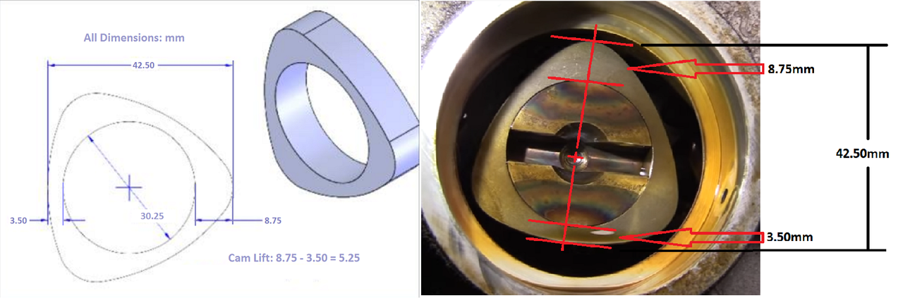

Lastly, a worn tri-lobe on the intake cam can cause fueling to suffer. It only take about 1mm to 1.5mm of wear for it to do so. So, if you run out of ideas...measure the tri-lobe stroke (cam lift) through the HPFP hole in the chain cover (requires turning the crank from a peak to a valley)...or remove the chain cover to measure:

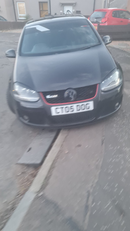

My GTI front grill was faded as was the lower grill… the red strip lacquer was pealing and turning pink, the GTI Badge chrome had seen better days. So I decided to change the lot.
Nice!, mines looking a little tired also, where did you get the grills from?

The cam looks fine btw, car has a CDL cylinder head with CDL cams, software made for them (I believe the CDL has higher lift)... I asked the owner if he got the software done with the old BYD cams then switched to the CDL stuff whilst leaving the old software untouched but he didn't.
