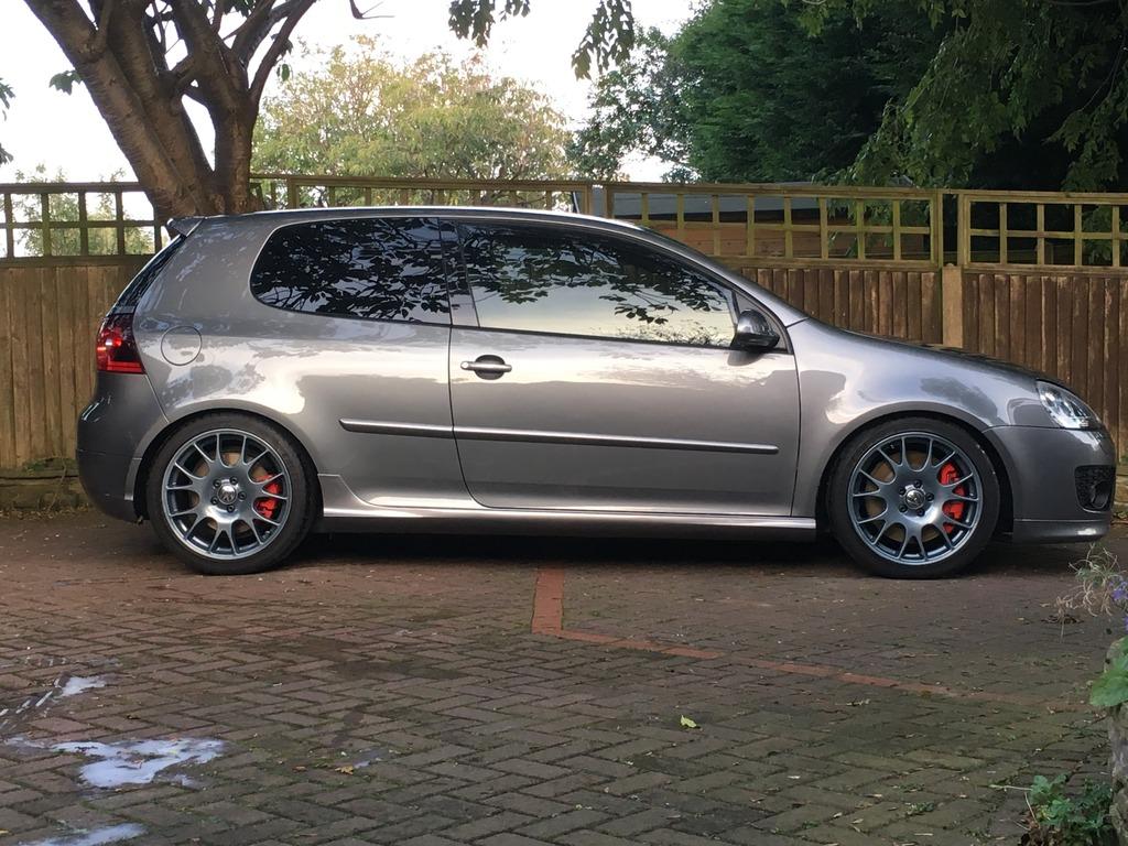

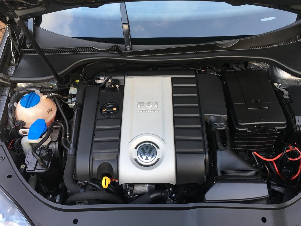

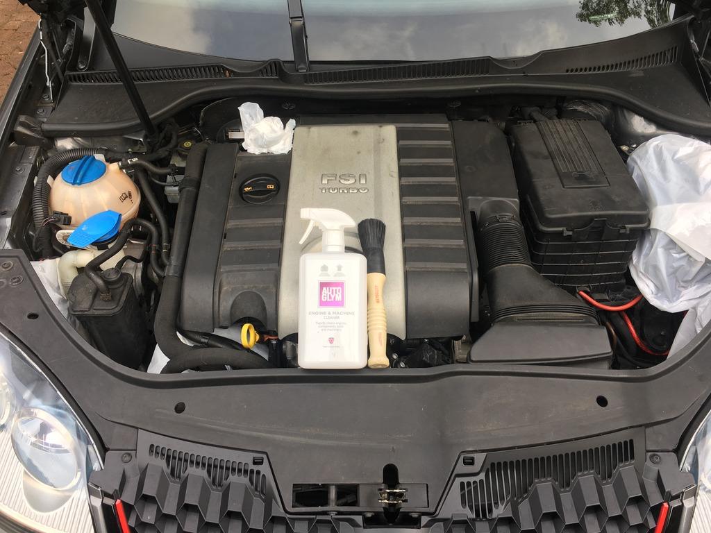

Gave my Ed30 a clean and did the engine bay while I was at it

@99hagued Very nice work!  :congrats:
