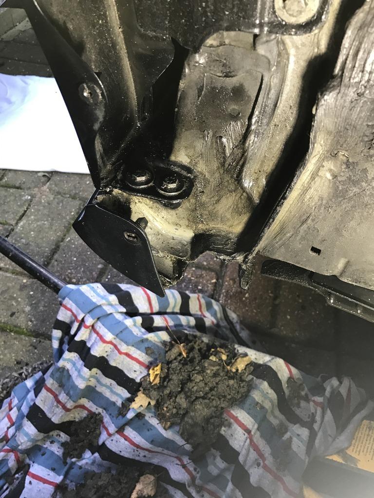

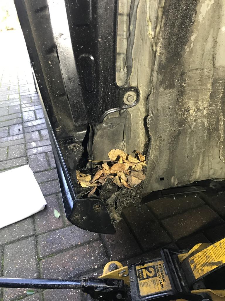

Annual crud clearing from behind the arch liner.  We know how MK5s love to rust, so prevention is better than the cure  :smiley:
The first time I did this after getting the car, the crud was half way up the wing, but not so bad after a year....
Back to how it should be  :smiley:  And yeah, that is a new wing under warranty.  VW don't paint the underside of it at the factory, tight barstewardss!

I've never thought of doing this before. Dam, another job on the list

Somebody else who needs to do this!  :thinking:

The reason mud flaps belong in the bin :happy2:

I remember when I took the plastic arch liners off my mk4 and the amount of mud behind there was unreal. Was 2 full dustpan and brush worth.
I am going to do the ed30 in a week or so when I get bored. Anyone know if removing the bit of sponge behind the arch is a good idea too? I've heard this aids in a lot of the rusty arches cases.

Yeah you just need to cut back the foam block an inch or so where it touches the arch's folded lip.  Don't need to remove the whole thing if you don't want to.
Yeah only do it if you're bored.  I did it whilst the car was on stands doing other stuff  :smiley:
My MK4 had shed loads back there too.  It must be the rubbish that falls down the scuttle drain holes?  I can't see how else that stuff can get behind there?  It was the soggy 'mud' that surprised me.  Not sure how that gets in there, but it stays wet for ages, which promotes rust.
